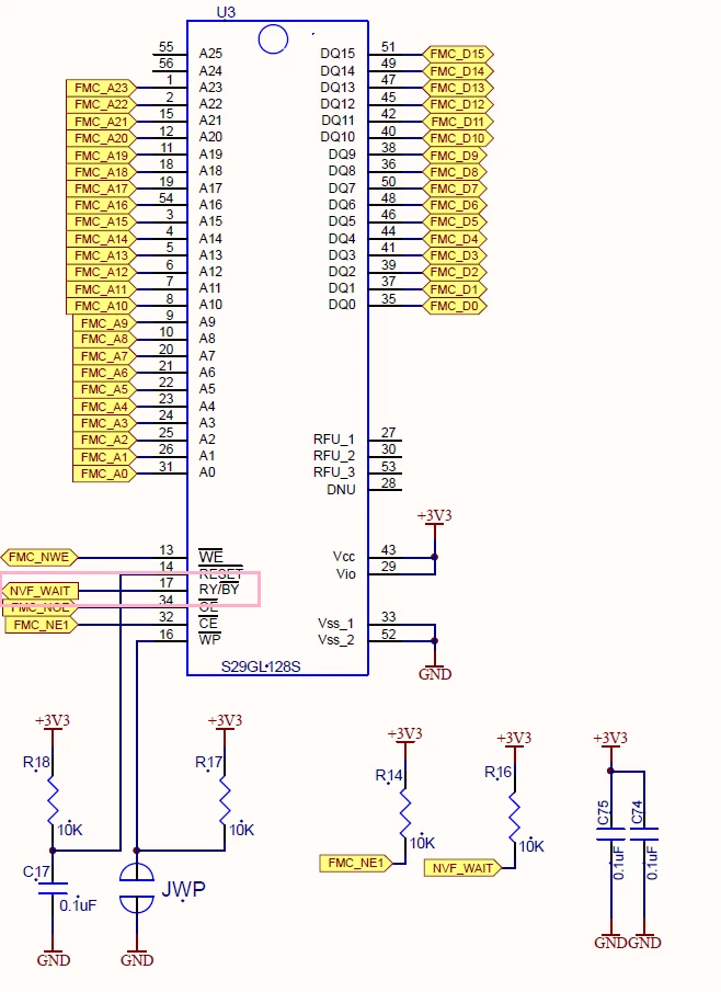

Hello
I generated a project with Stm32CubeMX with a NOR Flash connected in the FSMC. This NOR Flash has a Ready/Busy signal and the HAL NOR has a function to handle this signal: HA_NOR_MspWait. What can I do, if I want to implement this function without modifying the stm32f4xx_hal_nor.c file?
Best regards!

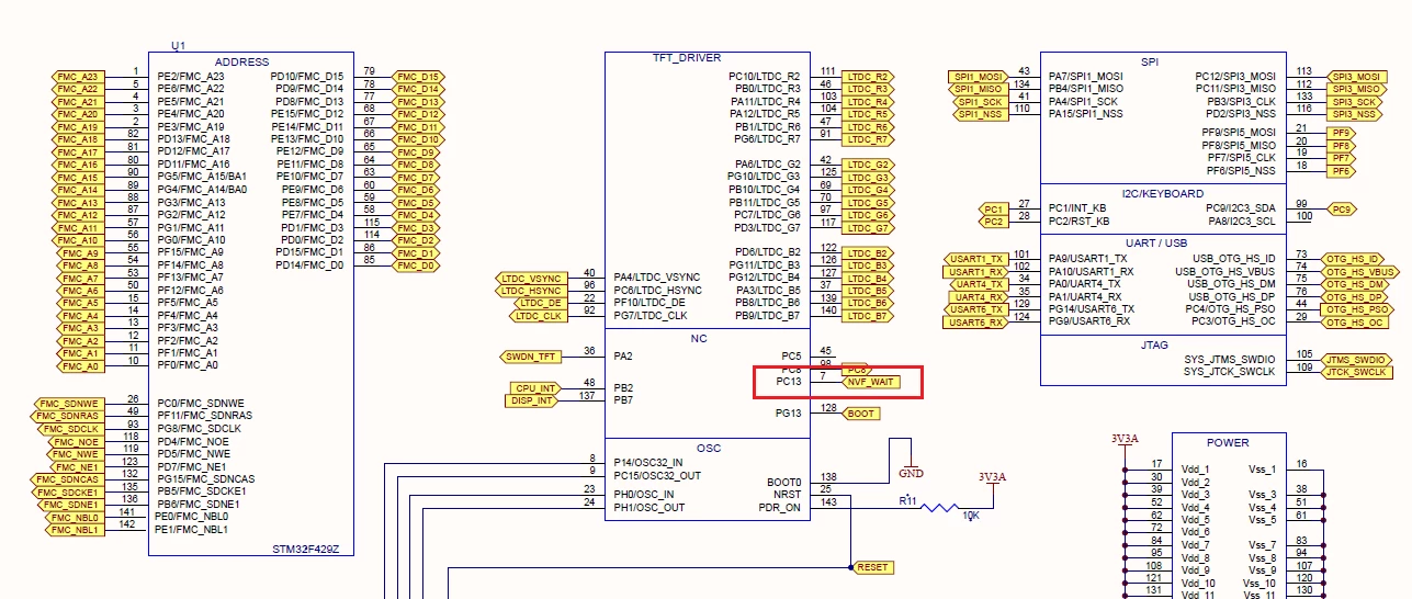

the datasheet Flash memory is
https://community.st.com/external-link.jspa?url=http%3A%2F%2Fwww.cypress.com%2Ffile%2F177976%2Fdownload
(S29GL128S). My current MCU is a SMT32F429 with a LCD. The NWAIT's pin is used by the LCD_B2 function of LCD's driver . RY/BY's signal is connected to PC13 (This pin hasn't an alternative function). My idea is manage the wait procedure implementing the HAL_NOR_MspWait function.
In the STM32F10x_StdExamples, there is an example of FSMC NOR without HAL implementation and the management of RD/BY signal. I think in my case, my HAL_NOR_MspWait has contain a code something like this:
