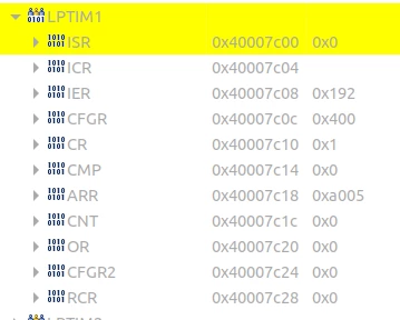

Hi. I am using STM32L412KBTx for my application. I am using LPTIM for 150ms and 5s timings.
The pattern is like 150ms-->5s-->150ms whenever data is received over LPUART.
So, for first 150ms timeout value, it runs fine and when I start for 5s timeout value, it returns HAL_TIMEOUT.
 (NOTE: I stop tier before starting again)
Below is the code from stm32l4xx_hal_lptim.c where i returns HAL_TIMEOUT:
/* Wait for the completion of the write operation to the LPTIM_ARR register */
 if (LPTIM_WaitForFlag(hlptim, LPTIM_FLAG_ARROK) == HAL_TIMEOUT)
 return HAL_TIMEOUT;

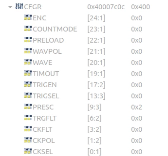

Here are the screenshots of LPTIM registers:
0693W00000QNrgAQAT.png0693W00000QNrgPQAT.png0693W00000QNrgjQAD.png0693W00000QNrhIQAT.pngAny Idea what is happening and how can I solve it?

Perhaps show more of your code? Specifically the HAL_LPTIM calls where you start/stop/restart/update the timer or timer regs.

I'm a bit rusty on HRTIM functionality... You aren't using the ARR preload function, so I would expect it to load immediately. Two differences I see between the working and non-working code:
  • non-working calls timer_stop() 2 times. Probably not an issue but worth a test.
  • working code calls start_timer() from an interrupt context (presuming the "Callback" function is a normal HAL IRQ callback). Non-working code calls from normal non-interrupt context.
Is there an HRTIM interrupt still active that may be trying to handle/clear the ARROK interrupt flag while start_timer() is calling the HAL_LPTIM_Counter_Start() function?
Memory corruption/stack overflow? (grasping at straws here)
