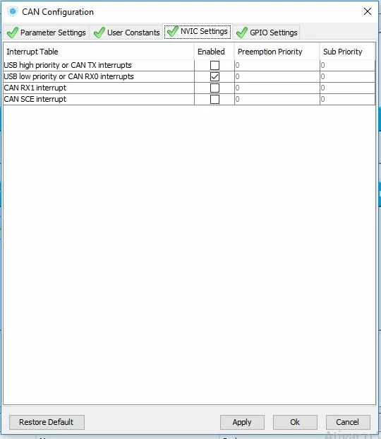

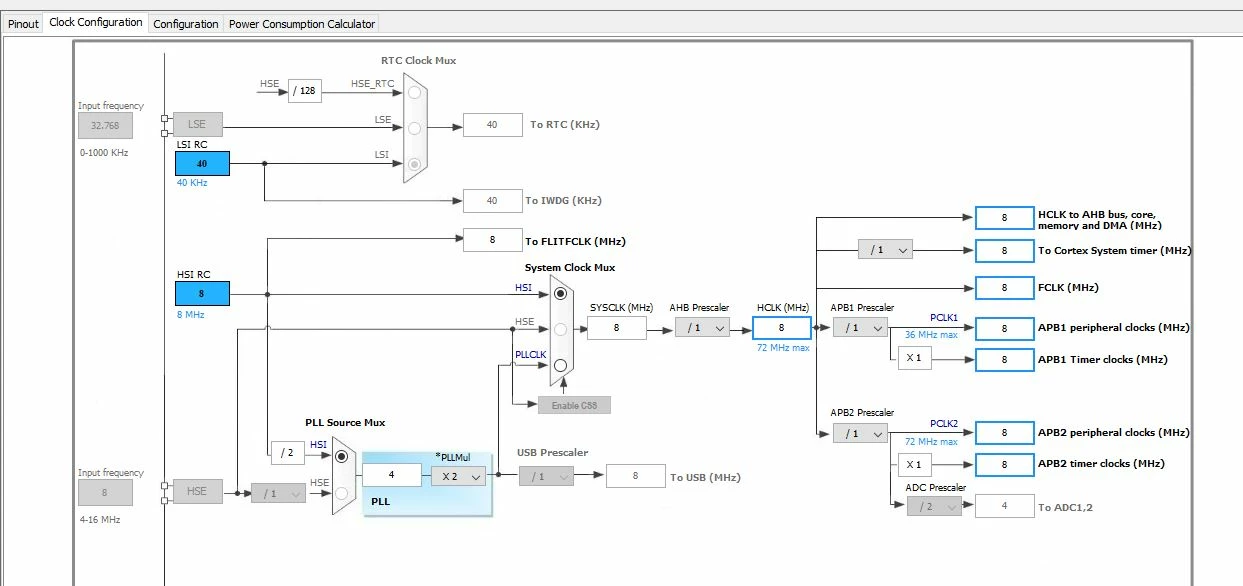

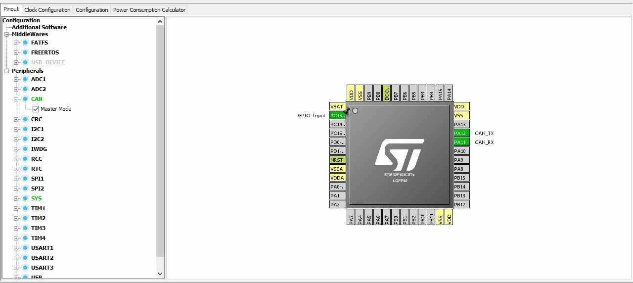

I am trying to use the HAL library to send data from a variable through CAN Network with interrupts. However my code is not sending data. Observing on the oscilloscope, the Tx Can pin is always on a high logic level. For this application I am using the stm32f103c8t6 microcontroller and the L9615D transceiver.
Could someone suggest what's wrong with my code?
I think I may have made some misconfiguration, I'm starting to work with the HAL library right now.
