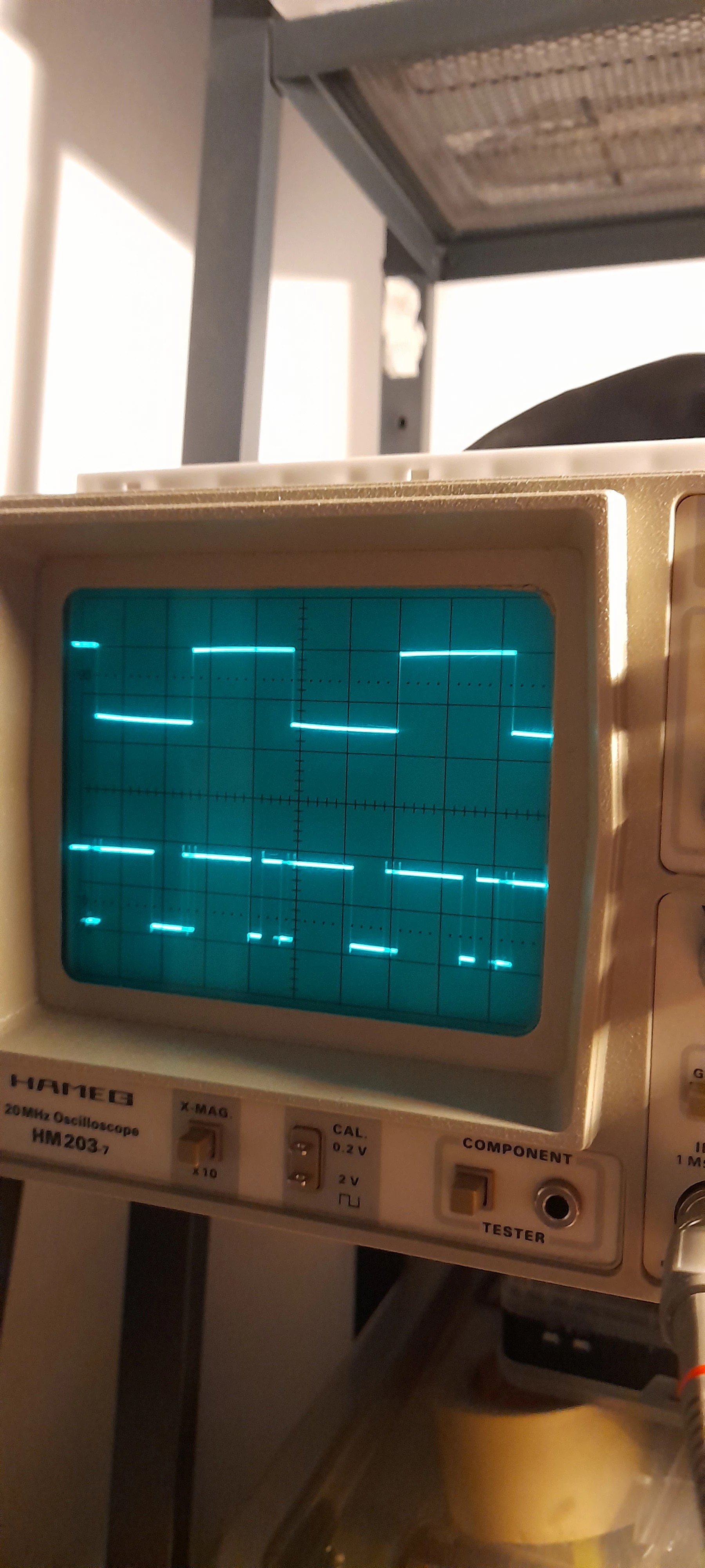

For a week i've been trying to configure my stm32f302cbt6 and the tlv320aic3254 codec to trasmit data to the mcu through i2s_ext_sd but HAL_I2S_Receive returns 0s to the buffer although i see data coming out of the codec. I have configured i2s2 peripheral, master clock in the pinout config, i configured the codec analog input and clocks to generate sample rate and all clocks and bit depths i've checked with the osciloscope seem to be within spec. i ve also called HAL_I2S_MspInit(&hi2s2); in the MX_I2S2_Init(void) function to set the default pins and played around wth the different setting but no luck.
Is there something obvious i am missing?
Any ideas would be enlightening!
Best Regards
Patsaoglou P.

16bit wclk and left and right codec data going into mcu

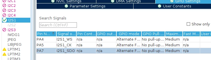

miso-x-mosi you mean trying on spi. I feel like I did something wrong with the mcu pins and the pin sending data from codec is configured as output instead of input?? I called HAL_I2S_MspInit(&hi2s2) but I feel I miss something on the pins.

AScha.3
Apr 1, 2023 12:44 PM UTC
no. just swap the two lines . (because i made this mistake, get zero data, because master IN connected to slave IN .)
and when set I2S in Cube, you can see, which pins are used, and the mode.

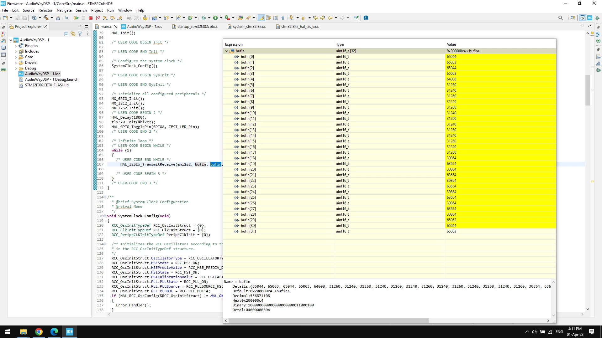

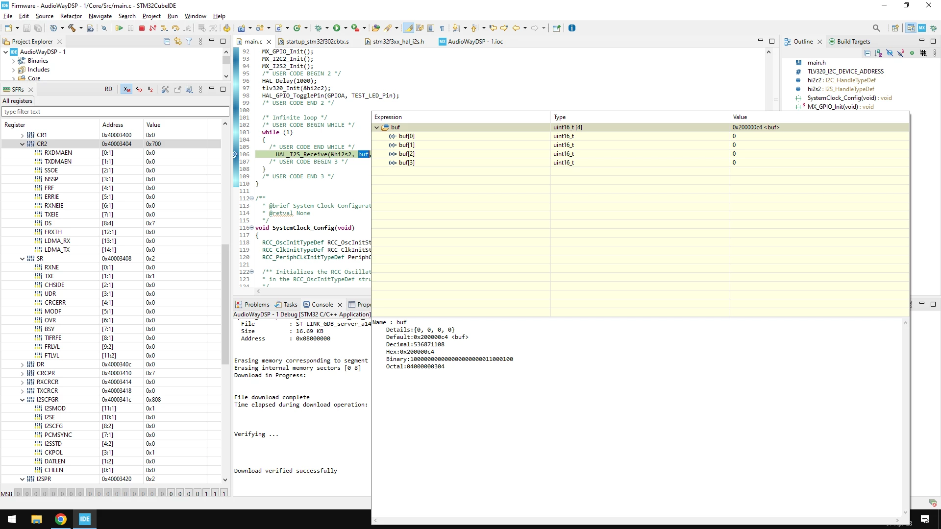

Well AScha.3 thanks for the response! Btw for a reason i cant change the send/receive pins from the .ioc
configurator for a reason! i used HAL_I2SEx_TransmitReceive and now i have real time data filling the buffer but i i also had to change hi2s2.Init.Mode from I2S_MODE_MASTER_RX to I2S_MODE_MASTER_TX.
A few things i ve noticed:
--When i use I2S_MODE_MASTER_RX, HAL_I2SEx_TransmitReceive returns 0 data
--When i use I2S_MODE_MASTER_TX and HAL_I2S_Receive returns 0 data and and i have no clock outputs from the mcu (master, word, bit clocks)
-- I have to use HAL_I2SEx_TransmitReceive in I2S_MODE_MASTER_RX that receives but also trasmits for the clocks to work and i found no way to only transmit
Is there a reason for all that or these trasmit/receive codecs you have to do both in order for them to work?
Thanks again for your time
