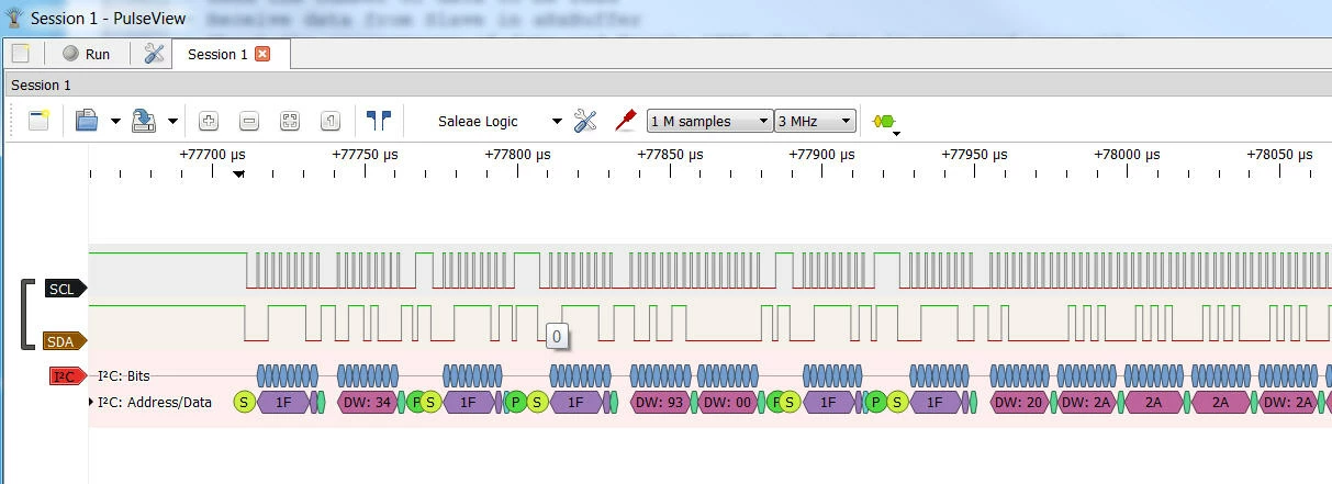

I'm trying to make I2C Slave using examples from Cube.
The wizard can write the register, but when reading the HAL_I2C_ListenCpltCallback  is called only once.
Can someone share their working code with me?  I don't understand how this should work.

Ok, in order for me to try to help please supply the following additional info
- chip or board you are using
- which Cube example are you using
- what are you using as master I2C
- IDE and link you are using
I will try to replicate your setup.
Frank.

I use trueSTUDIO and STM32F101C8U
I looked at an example in , F0_V1.8.0\Projects\STM32F072RB-Nucleo\Examples\I2C\I2C_TwoBoards_RestartAdvComIT
I don't understand anything, now my call stack is like this:

To let you know, I built the example project on 2 boards (not Nucleo - my own hardware) and it works fine.
Its not clear why your call stack looks the way it does. Just a shot in the dark - in your slave code did you enable address listen mode using HAL_I2C_EnableListen_IT() ? You dont show it in your code. EDIT: correction, it is there.
May be worth getting a logic analyzer hooked onto the bus. Below a trace of some of the master -> slave transmit data from the example.
