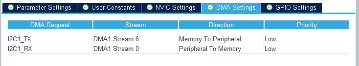

Try with this configuration and let me know if this is helpful or not :
Foued

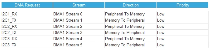

I tried you suggested config with the same result. My config for the DMA is
At the moment I am only using I2C1, but eventually need to use I2C2/3. I am using FreeRTOS and the code to read the I2C in a thread of its own. I will try to create a minimal project that only does the I2C stuff (no RTOS or anything else) and report back.
