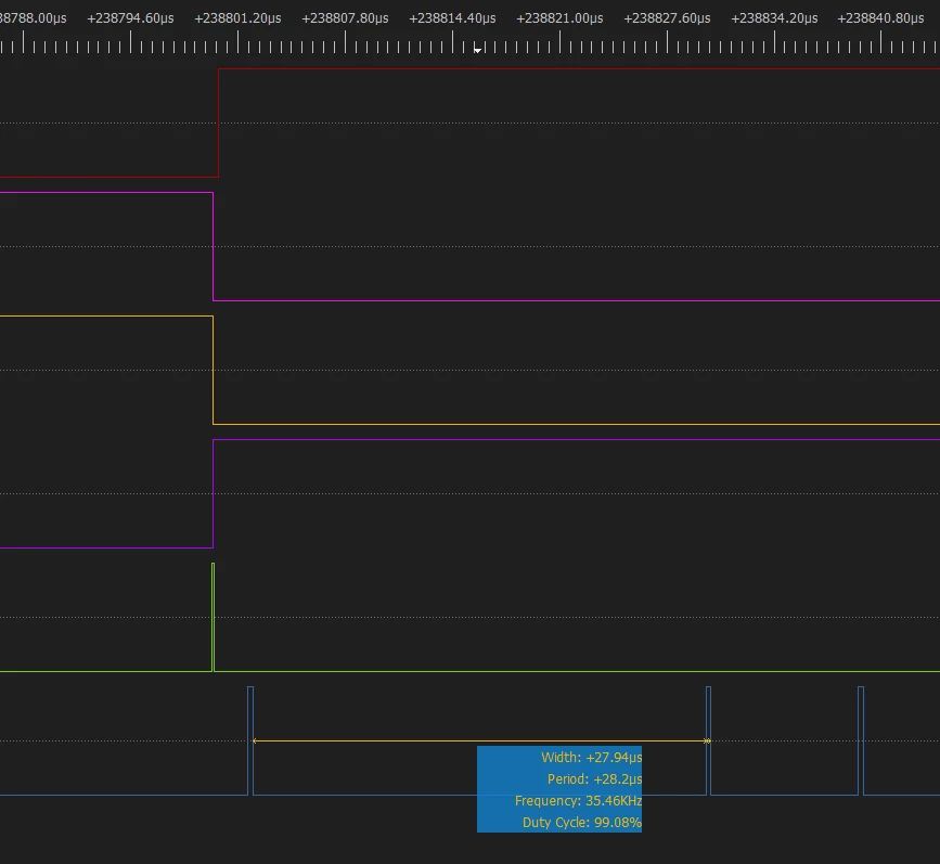

Hi. Im using HRTIM and HAL in my project.
To stop Master timer with subsequent interrupt call I use HAL_HRTIM_WaveformCounterStop_IT (it is defined in stm32_hal_legacy.h) and it calls HAL_HRTIM_WaveformCountStop_IT from stm32g4xx_hal_hrtim.c.
Pic.1 shows how long it takes to process this function call, and it is enormous 27.94us.
Yes, I know HAL is kinda slow and for maximum efficiency one should use direct registers call.
I suggest the culprit is delay inserted in this function (variable called "delai").

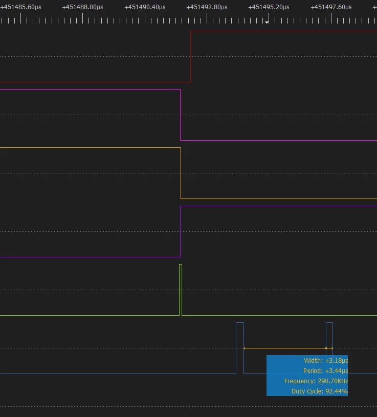

 When I commented line 40
 /* ++ WA */
// do { delai--; } while (delai != 0U);
 /* -- WA */
execution time drastically decreased to 3.18us (Pic. 2).
So the question is:
What is the purpose of this delay?
Can I just comment it?
What is "WA" mean in the comments near delai? (workaround?).
I did not find any mentions about it in errata, and I checked that this delay was there since version 1.0.0 of STM32Cube MCU package.Pic.1 HAL_HRTIM_WaveformCountStop_IT call execution time.Pic.1 HAL_HRTIM_WaveformCountStop_IT call execution time.Pic.2 HAL_HRTIM_WaveformCountStop_IT call execution time with commented delai cycle..Pic.2 HAL_HRTIM_WaveformCountStop_IT call execution time with commented delai cycle..
