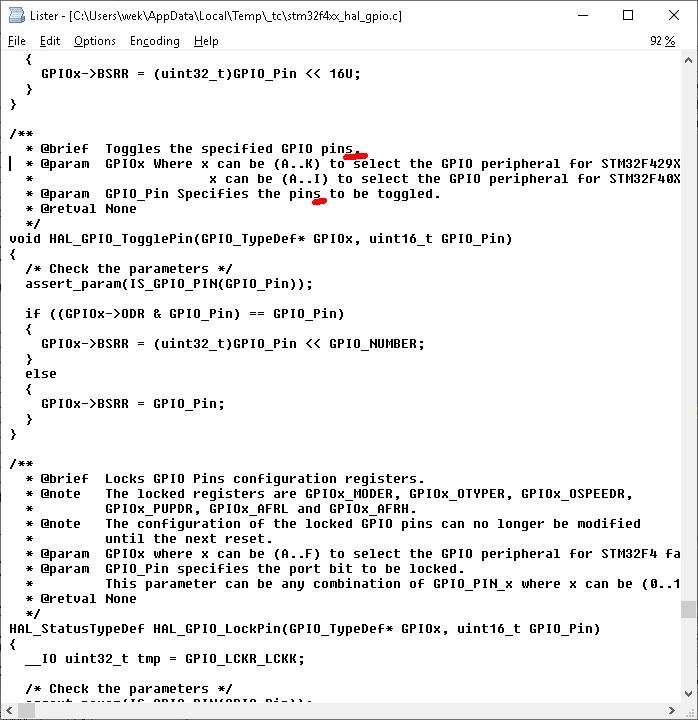

> Looking at the name of the new function, I would think that you are only supposed to toggle a single pin
Well maybe, but the documentation says otherwise:
So, I say, yes, this *is* a bug, and ST should use your implementation, so keep to their own API and not to break existing code (plus fix the assertion accordingly).

Thank you for the reply. Waclawek has pointed what I have missed out in my initial post. I went through the documentations/comments of the function and It convinced me that it is allow user to toggle multiple pins. The "assert_param" doesn't work at all in this case.
