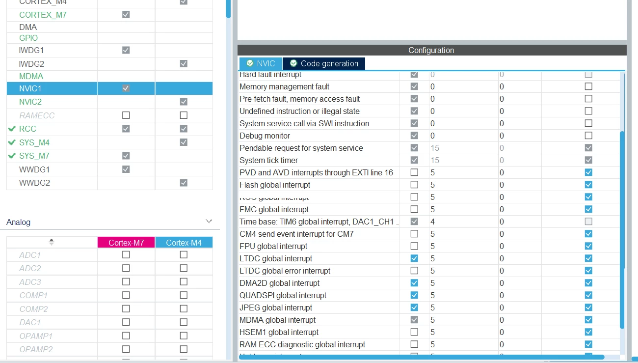

November 26, 2024
Thank you for this.
Incase anybody needs this. I had some issues initializing my sdram and somehow the function keeps getting stuck at HAL_GetTick(); , and the function returns 0. Turns out that my interrupt setting in the Time base: TIM6 global interrupt was set to 15. After changing it to a higher priority which is 4. My problem is solved and I am finally able to see my LCD screen. Just a back note, TIM6 was used for my M7 processor.
