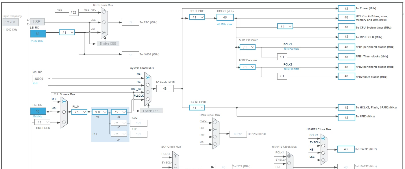

For completeness sake, here's a message of the Clock configuration (the bottom half outside the picture is all greyed out and as per default).

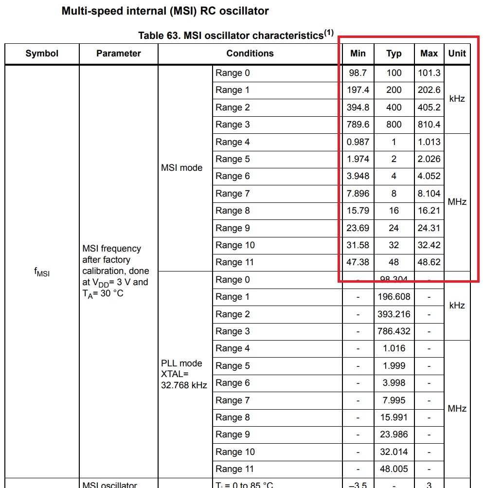

mƎALLEm
Oct 15, 2024 1:16 PM UTC
Hello @bns  and welcome to the community,
@bns wrote:
+ You are using an internal source of Clock based on RC cell not a precise clock source as Crystal / HSE.
Did you try with an external crystal?

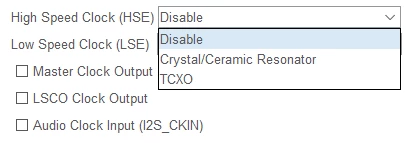

Sorry for my obliviousness - how would I configure this? I do now see the options for the HSE/LSE in the System Core / RCC tab. What values would I need to set their options to, for the LoRa-E5? Would I also set it to Master Clock Output?
mƎALLEm
Oct 15, 2024 1:34 PM UTC
You need to set Crystal/Ceramic Resonator. But you need definitely having an external Crystal connected to OSC_IN and OSC_OUT pins.
bnsAuthor
Oct 15, 2024 1:41 PM UTC

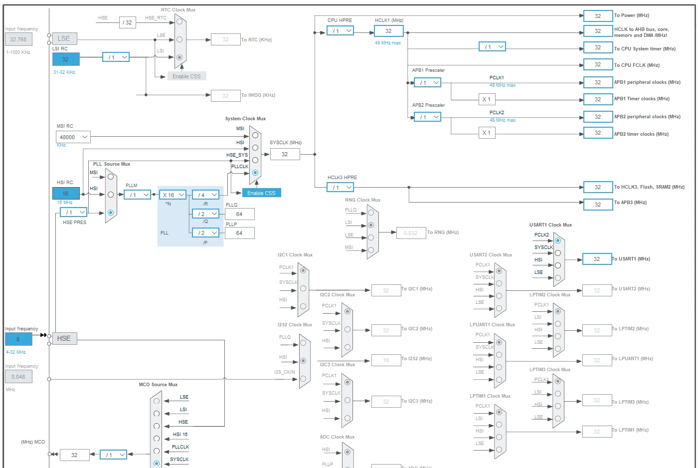

According to the Seeed wiki, the LoRa-E5 has a TCXO connected at 32MHz. After configuring that as the HSE source, I would like to use it as the clock source.
Would the following Clock configuration make sense, or would it likely result in troubles? My apologies - I don't really have a feeling for it yet, besides knowing that I can't really go below ~20MHz for CPU/SPI.
