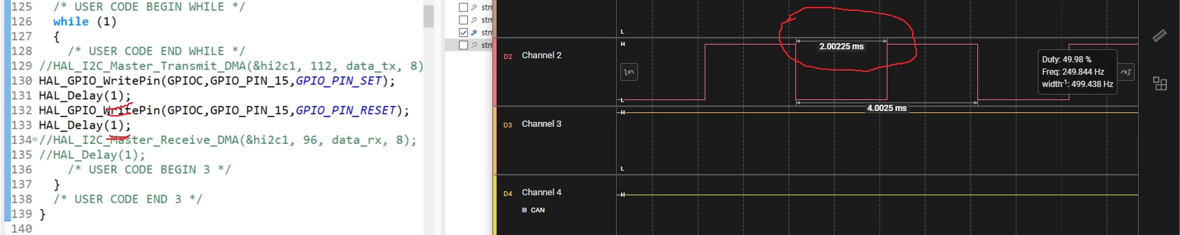

HAL_Delay(1); takes 2ms
Hello
I just found out that the HAL_Delay() delay actually takes 1ms longer than the desired value. Why?

Because it's an "at-least-N-ms" delay with 1ms granularity.

PNova.2
PNova.2Author
Jun 12, 2023 6:08 AM UTC
waclavek.jan,Tesla DeLorean, S.Ma :

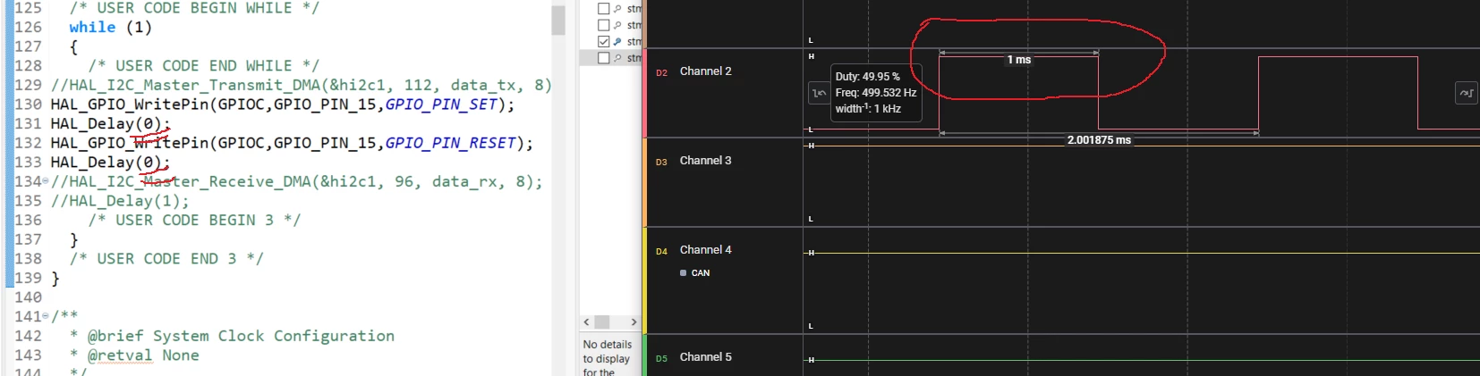

But I'm not interested in accuracy. The time is always accurate, just always +1ms, because as I found out, the function automatically increments the variable at the beginning.
__weak void HAL_Delay(uint32_t Delay)
 uint32_t tickstart = HAL_GetTick();
 uint32_t wait = Delay;
 /* Add a freq to guarantee minimum wait */
 if (wait < HAL_MAX_DELAY)// allways add uwTickFreq (1)
 wait += (uint32_t)(uwTickFreq);
 while((HAL_GetTick() - tickstart) < wait)
For values in hundreds of milliseconds it is of course not important, but for 1ms it does 100%. And that caused me a problem that I only discovered by using a logic analyzer.
Of course, it is a weak function that I can override according to my needs, but I was more interested in the reason why it is so.
Sure, the comment says that it should guarantee at least a minimal delay, but it can certainly be better:
 if (wait < 1)
Or am i wrong?
Tesla DeLorean
Guru
Jun 12, 2023 8:41 AM UTC
Depends when it is called.
A fraction of a second prior to the systick will result in a very short delay.
The solution is really to have a time base that resolves in much finer resolution, say 1 or 2 orders of magnitude.
