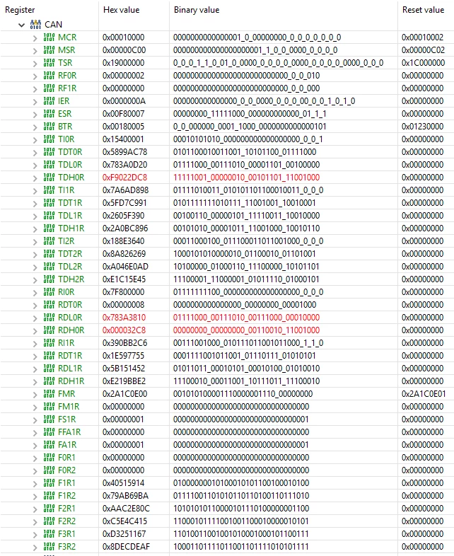

I'm using one STM32F2 board and two STM32F3 boards. The F2 is the CAN master and the F3 are slaves. Everything works fine if I use only one F3 board. If I add the other one, then after 30sec - 5min one of the F3 boards is going to always return HAL_TIMEOUT from HAL_CAN_Transmit.
This is the code from HAL_CAN_Transmit that always returns HAL_TIMEOUT.
 /* Check End of transmission flag */
 while(!(__HAL_CAN_TRANSMIT_STATUS(hcan, transmitmailbox)))
 /* Check for the Timeout */
 if(Timeout != HAL_MAX_DELAY)
 if((Timeout == 0U) || ((HAL_GetTick()-tickstart) > Timeout))
 hcan->State = HAL_CAN_STATE_TIMEOUT;
 /* Cancel transmission */
 __HAL_CAN_CANCEL_TRANSMIT(hcan, transmitmailbox);
 /* Process unlocked */
 __HAL_UNLOCK(hcan);
 return HAL_TIMEOUT;
I'm using STM32CubeF3 V1.9.0
Here is a snapshot of my CAN registers right before the return HAL_TIMEOUT;
0690X00000609BoQAI.png #can-bus #stm32-f3 #hal #can

The bug gets triggert if there is a collision on the CAN bus. eg. if two devices send a frame with the same CAN priority at the same time. This will permanently lockup the TX of one of the devices.

its the same message ID issue.
different boards should use different message IDs
after a bus error like that, you have to power cycle all the boards.
