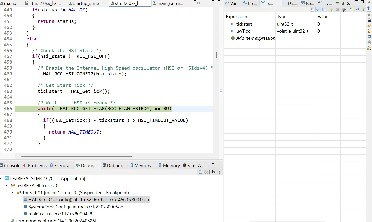

Hi all,
STM32 start executes the following during startup in main.c:
  1. HAL_Init();
  2. SystemClock_Config();
  3. Initialize all configured peripherals (e.g., MX_GPIO_Init())
  4. Enter the main while loop
However, I've observed a cold-start issue:
  • If the power supply is disconnected for 3–5 seconds or more, the system hangs and never reaches the main while loop after reboot.
  • If the supply is disconnected for a short interval or a manual reset is applied, the system boots normally.
While debugging, I suspected that the LSE/LSI/HSI oscillators might need more time to stabilize.
Looking into HAL_RCC_OscConfig(), it waits for the HSI to be ready by checking RCC_FLAG_HSIRDY with a timeout mechanism:
 /* Get Start Tick */
 tickstart = HAL_GetTick();
 /* Wait till HSI is ready */
 while(__HAL_RCC_GET_FLAG(RCC_FLAG_HSIRDY) == 0U)
 if((HAL_GetTick() - tickstart ) > HSI_TIMEOUT_VALUE)
 return HAL_TIMEOUT;
When I set a breakpoint here, I noticed:
  • tickstart is always 0
  • HAL_GetTick() always returns 0
It seems the HAL tick is not advancing at this point, causing the function to hang indefinitely.
Has anyone encountered a similar issue, or can explain why HAL_GetTick() would not increment during system clock configuration at cold start? Any suggestions on how to fix this would be greatly appreciated.

chai2145Author
October 2, 2025
Hi @Saket_Om , are you able to get the tickstart value? For my side is always 0 as shown in image below.
October 2, 2025
Hello @chai2145,
If you are using the NUCLEO-L053R8, please ensure the following hardware modifications:
  • Turn OFF solder bridges SB54 and SB55
  • Remove resistor R35
  • Turn ON solder bridges SB16 and SB50
After making these changes, test your setup using the RCC_ClockConfig example to verify proper operation.

chai2145Author
October 3, 2025
Im using STM32L071RZH6 MCU
