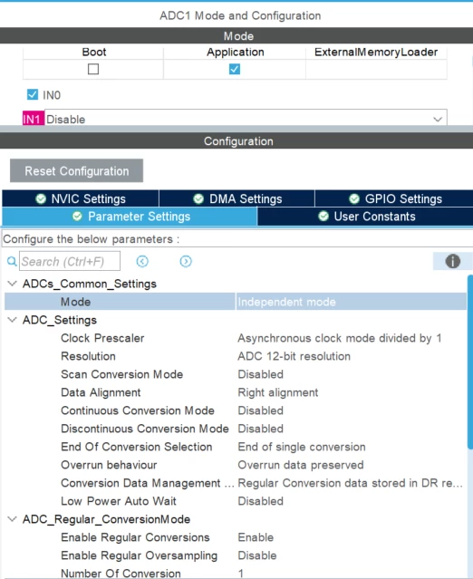

@Chris21 It's this code here right? (I could be wrong, this was autogenerated)

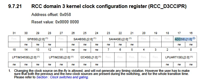

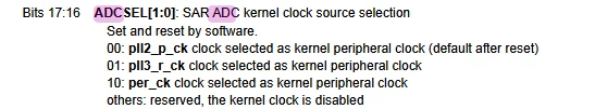

March 4, 2025
Looks like the H7 is a bit different as far as the ADC Clock, it's set in RCC domain 3 kernel clock configuration register (RCC_D3CCIPR):
