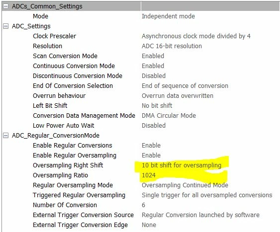

I am currently seeing an assert_param failure within the HAL_ADC_Init() method in stm32h7xx_hal_adc.c file.
Specifically the following assertion is failing:
assert_param(IS_ADC_RIGHT_BIT_SHIFT(hadc->Init.Oversampling.RightBitShift));
The value being passed into the assertion is 0x140 which is being initialised in MX_ADC1_Init() and MX_ADC3_Init() as follows:
hadc1.Init.Oversampling.RightBitShift = ADC_RIGHTBITSHIFT_10;
hadc3.Init.Oversampling.RightBitShift = ADC_RIGHTBITSHIFT_10;
I believe the actual issue is the macro in the file stm32h7xx_hal_adc_ex.h:
#define IS_ADC_RIGHT_BIT_SHIFT(__SHIFT__) (((__SHIFT__) == ADC_RIGHTBITSHIFT_NONE) || \
 ((__SHIFT__) == ADC_RIGHTBITSHIFT_1 ) || \
 ((__SHIFT__) == ADC_RIGHTBITSHIFT_2 ) || \
 ((__SHIFT__) == ADC_RIGHTBITSHIFT_3 ) || \
 ((__SHIFT__) == ADC_RIGHTBITSHIFT_4 ) || \
 ((__SHIFT__) == ADC_RIGHTBITSHIFT_5 ) || \
 ((__SHIFT__) == ADC_RIGHTBITSHIFT_6 ) || \
 ((__SHIFT__) == ADC_RIGHTBITSHIFT_7 ) || \
 ((__SHIFT__) == ADC_RIGHTBITSHIFT_8 ))
which only checks values up to ADC_RIGHTBITSHIFT_8 and does not include the possible values of ADC_RIGHTBITSHIFT_9, ADC_RIGHTBITSHIFT_10 and ADC_RIGHTBITSHIFT_11 which are possible on the STM32H7.
I propose update the macro to include the missing potential values.

@[Houssem CHAABANI]​
Thanks for you're reply. If that is the case then CubeMX is setting the value incorrectly.
If have set the oversampling ratio for both ADCs to 1024 in CubeMx. The oversampler right bit shift is also set to 10 bits in CubeMX, which results in the oversampler value being set to ADC_RIGHTBITSHIFT_10 in the initialisation code. This fails the assertion. Below is an image showing my ADC setup.
I'm not manually initialise the ADCs but just running the code generated from CubeMX. So it could be a problem with the CubeMX code generation? Or CubeMX is allowing you to set invalid options?
I don't think setting the value to ADC_RIGHTBITSHIFT_8 as you suggested would work as my adc samples would end up 4 times too big. Oversampling ratio would also need to be adjusted to 256?
Perhaps I'm misunderstanding the role of the ADC right bit shift and oversampling ratio. Logically I think that if I accumulate 1024 samples, I need to then divide by 1024 to get the averaged ADC value.
1024 = 2^10

Hello @Simon Sq​
Thank you for these details.
According to stm32h7xx_hal_adc.h the ADC_RIGHTBITSHIFT_10 is defined.
@Imen DAHMEN​  could you please check if there is a problem with the stm32h7xx_hal_adc_ex.h file ?
Best regards
Houssem

@Houssem CHAABANI​  @Imen DAHMEN​  I believe there is an issue with stm32h7xx_hal_adc_ex.h file in that the IS_ADC_RIGHT_BIT_SHIFT() macro does not include the possible values for ADC_RIGHTBITSHIFT_9, ADC_RIGHTBITSHIFT_10, and ADC_RIGHTBITSHIFT_11 - it only goes up to ADC_RIGHTBITSHIFT_8.
In my opinion the IS_ADC_RIGHT_BIT_SHIFT() macro in stm32h7xx_hal_adc_ex.h needs to be changed to include the missing values.
November 5, 2020
Hello @Simon Sq​ ,
Thank you for pointing me out this issue.
I will check this reported problem and I will come back to you with update and the actions taken.
Imen
November 16, 2020
Hello @Simon Sq​ ,
I confirm the issue and I have passed it along to our development team for fix.
Thanks for your contribution and for pointing out this issue.
Imen
