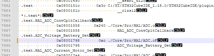

HAL_ADC_ConvCpltCallback optimized away
Post edited to follow the community rules: Please review how to share a code in this post.
Using the stm32g030k8 and the Version: 1.18.1 STM32CubeIDE
I just recently applied an optimization in order to get more space for my application firmware. And then I realize that the HAL_ADC_ConvCpltCallback has been optimized away. I use the -Og (debug optimization) to use the less agressive and more debug friendly optimization.
__attribute__((used)) void HAL_ADC_ConvCpltCallback(ADC_HandleTypeDef *hadc1)

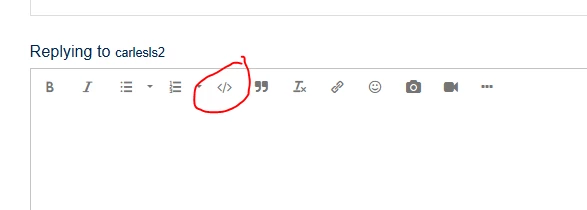

First, there is a "insert code sample" menu entry, which makes code snippets like yours much more readable.
Second, declare your ADC_Average_Buff array volatile.
How are you sure that the function has been optimised away?
As @Ozone suggests, if you haven't qualified things which get modified in the callback as volatile, then accesses to those variables may get optimised-out.
@carlesls2 wrote:
I also check if the ADC_DMAConvCplt or HAL_ADC_IRQHandler or DMA1_Channel1_IRQHandler are being called, but they are not being called.
Sounds like the hardware interrupts are not happening...
carlesls2
carlesls2Author
Jun 16, 2025 10:04 AM UTC
I does not seem optimized away... it exists in the .map file. I guess this is not discarted... it seems not optimized away but it is never called. Yet this occurs when the optimization is applied.
Why do you think it's optimized away? Convince us.
Ensure ADC_Average_Buff is set to volatile.
carlesls2
carlesls2Author
Jun 17, 2025 7:52 AM UTC
I am not sure but whenever the optimization is applied (when I apply the -Og optimization) the HAL_ADC_ConvCpltCallback is never triggered. The It may not be optimized away but this occurs because of the optimization.
I created a new smaller project to see if the HAL_ADC_ConvCpltCallback is being optimized away and it is not.
Ozone
Principal
Jun 17, 2025 8:10 AM UTC
To be more explicit - apply your "-Og" optimisation settings, and set a breakpoint in the ADC interrupt handler before the branch to the callback(s).
Unless a simple code review reveals the reason.
