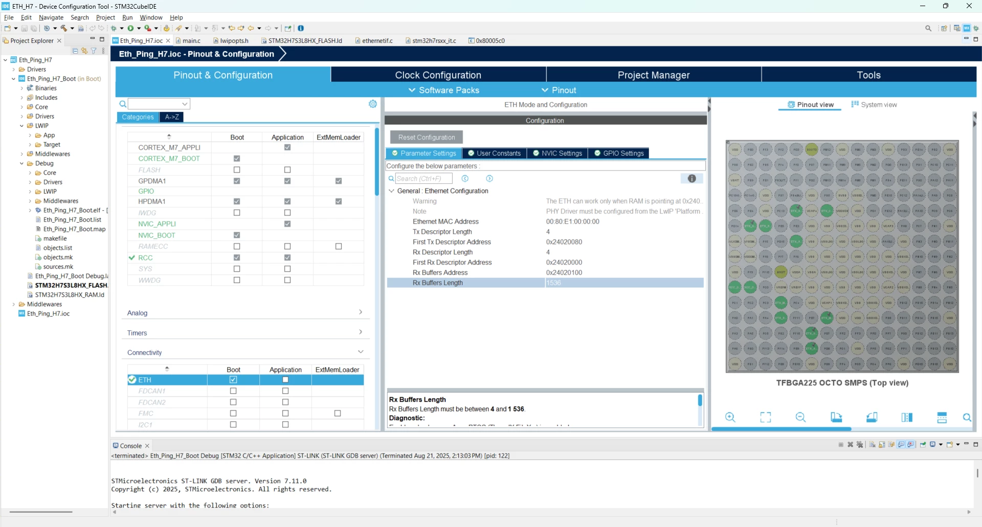

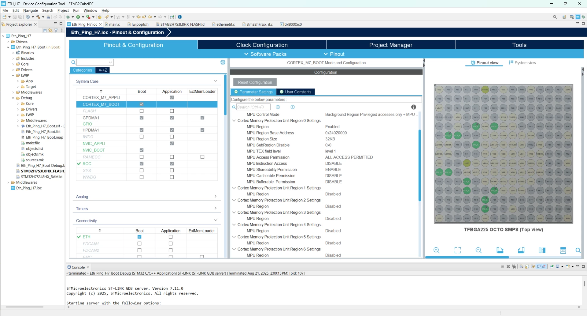

I have followed the article (https://community.st.com/t5/stm32-mcus/how-to-create-a-project-for-stm32h7-with-ethernet-and-lwip-stack/ta-p/49308#memory-layout ) to get it working for ethernet but I am facing hardfault. In H7S3L8 I am using AXI-SRAM at address 0x24020000 for ethernet buffers and lwip and configuring this sram as non cacheable, non bufferable and shareable at level 1
I am getting hardfault. I is related to memory but I am not able to resolve it. Any help me to find where is the  problem?
