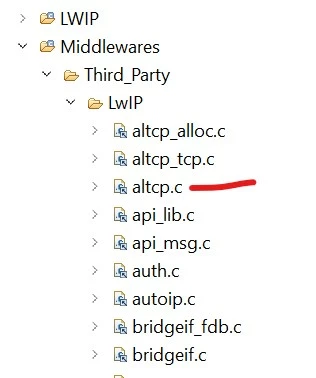

H750-DISCO error: no rule to make altcp.c; needed by altcp.o
21:56:14 **** Incremental Build of configuration Debug for project H745_Ethernet_PING_CM7 ****
make -j8 all
make: *** No rule to make target 'C:/Users/STM32CubeIDE/workspace_1.10.1/H745_Ethernet_PING/Middlewares/Third_Party/LwIP/src/core/altcp.c', needed by 'Middlewares/Third_Party/LwIP/altcp.o'. Stop.
"make -j8 all" terminated with exit code 2. Build might be incomplete.
21:56:15 Build Failed. 1 errors, 0 warnings. (took 706ms)
Hello... i entered this error on H750-DISCO running on Ethernet MII , anyone can pls help, TQ!
mƎALLEm
mƎALLEmBest answer
Mar 5, 2025 7:59 AM UTC
Remove it from your project tree and add it again using drag and drop.

Mar 4, 2025 2:08 PM UTC
This means altcp.c is missing in this path: Middlewares/Third_Party/LwIP/src/core or may be you don't need it, so try to remove it from your project tree.
Mar 4, 2025 2:24 PM UTC
ok i see what u mean, it is in the folder, albeit in a different path, could u advise how to point to the correct path? TQ!
Mar 4, 2025 11:59 PM UTC
hello.. could anyone advise how to set the correct path:  .. LWIP\Middleware\Third_Party_LwIP\altcp.c?
