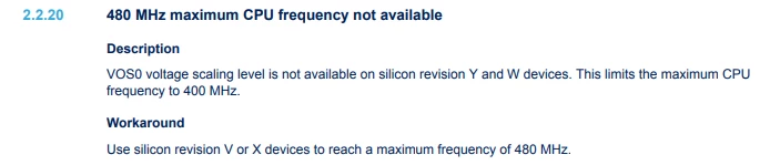

I found an errata that says there is a hardware problem with some revisions of this chip.  Cannot go above 400MHz...
I think we recently purchased these chips from distribution....

As it's generated with CubeMx/CubeIDE I don't think there is an issue in the clock config and indeed rev V can reach 480MHz with VOS0.
I'm not expert of ETH but does the product run with a simple example at 480MHz? What is the product package are you using?

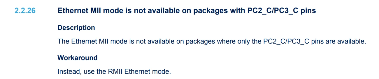

See also this errata:
Ok I see you are using LAN8742 (RMII) so you are not in this errata ..
