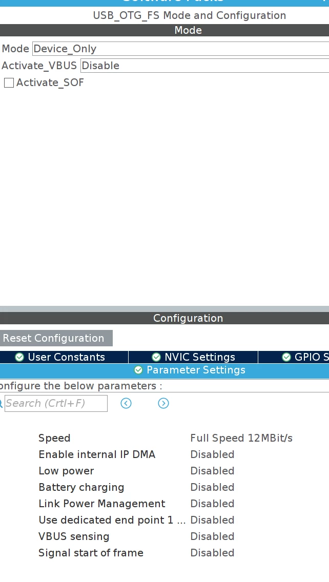

Hello @Community member​ ,
Welcome to th STM32 Community :smiling_face_with_smiling_eyes:.
Check the peripheral clock speed, it maybe needed to increase.
Also, check the USB_OTG_FS configuration, and tried disabling VBUS sensing.

JBere.1
JBere.1Author
Jan 10, 2021 6:02 PM UTC
Hi Imen,
Thanks for contacting.
Checked Speed Peripheral (see attached, in case I missed), and Disabled VBUS Sensing(see attached).

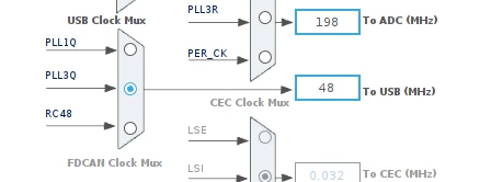

JBere.1
JBere.1Author
Jan 10, 2021 6:04 PM UTC
Hi Imen,
USB Peripheral Speed set to 48Mhz using RC48 and PLL3Q.
