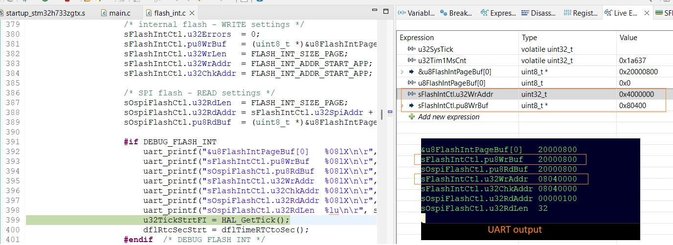

Debug: I tried, but for these variables the display in CubeIDE had some problems:
                 sFlashIntCtl.pu8WrBuf: 0x80000 <error: Cannot access memory at address 0x80000>
I’ll try that again.

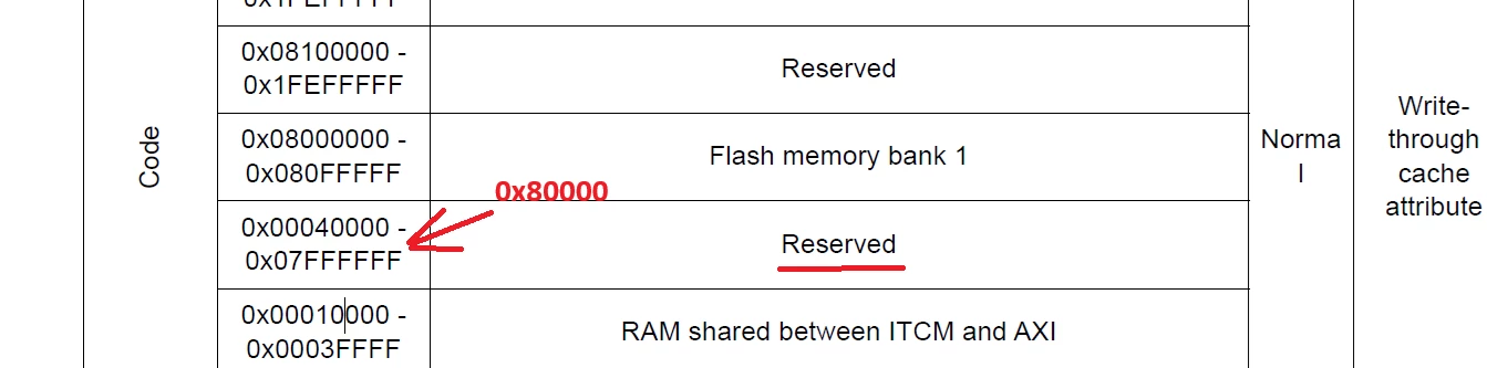

mƎALLEm
Jun 9, 2026 15:49 UTC
Address at 0x80000 ?

Here’s an extract of function A, which sets things up then calls function B = FlashIntWrPage

sFlashIntCtl.pu8WrBuf = (uint8_t *)&u8FlashIntPageBuf[0];
sFlashIntCtl.u32WrLen = FLASH_INT_SIZE_PAGE;
sFlashIntCtl.u32WrAddr = FLASH_INT_ADDR_START_APP;
sFlashIntCtl.u32ChkAddr = FLASH_INT_ADDR_START_APP;
/* SPI flash - READ settings */
sOspiFlashCtl.u32RdLen = FLASH_INT_SIZE_PAGE;
sOspiFlashCtl.u32RdAddr = sFlashIntCtl.u32SpiAddr + OCTOSPI_FILE_BUF_OFFSET;
sOspiFlashCtl.pu8RdBuf = (uint8_t *)&u8FlashIntPageBuf[0];
#if DEBUG_FLASH_INT
uart_printf("&u8FlashIntPageBuf[0] %08lX\n\r", (uint32_t)&u8FlashIntPageBuf[0]);
uart_printf("sFlashIntCtl.pu8WrBuf %08lX\n\r", (uint32_t)sFlashIntCtl.pu8WrBuf);
uart_printf("sOspiFlashCtl.pu8RdBuf %08lX\n\r", (uint32_t)sOspiFlashCtl.pu8RdBuf);
uart_printf("sFlashIntCtl.u32WrAddr %08lX\n\r", sFlashIntCtl.u32WrAddr);
uart_printf("sFlashIntCtl.u32ChkAddr %08lX\n\r", sFlashIntCtl.u32ChkAddr);
uart_printf("sOspiFlashCtl.u32RdAddr %08lX\n\r", sOspiFlashCtl.u32RdAddr);
uart_printf("sOspiFlashCtl.u32RdLen %lu\n\r", sOspiFlashCtl.u32RdLen);
u32TickStrtFI = HAL_GetTick();

Jun 9, 2026 15:59 UTC
different kind of wrong now, CubeIDE Debug vs UART

LCE
LCEAuthor
Principal III
Jun 10, 2026 08:22 UTC
I found that in OspiFlashRdPage() another struct’s member (sSpiFileInfo.u32Size) is reset, which is also not used in that function.
After a few “sOspiFlashCtl.u32RdRcvd++;” in OspiFlashRdPage() (see code above)  sSpiFileInfo.u32Size is also changed.
EDIT:
ITCM RAM is used for heap & stack, some functions, and the vector table. Changing this didn’t change anything.
I also turned off the optimization for some functions with
__attribute__((optimize("O0")))
before function declaration.
Also no change.
