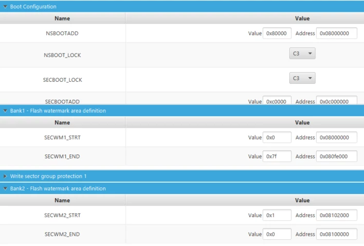

I'm testing the use of trustzones in my application. The examples are working fine, however my application requires more FLASH in the non-secure zone than in the secure zone. The initial examples have the following parameters (default):
The memory definition in the secure linker script is as follows:
/* Memories definition - Secure Zone  */
MEMORY
RAM (xrw) : ORIGIN = 0x30000000, LENGTH = 320K
FLASH (rx) : ORIGIN = 0x0C000000, LENGTH = 1016K
FLASH_NSC (rx) : ORIGIN = 0x0C0FE000, LENGTH = 8K
The memory definition in the non-secure linker script is as follows:
/* Memories definition - Non-Secure Zone */
MEMORY
RAM (xrw) : ORIGIN = 0x20050000, LENGTH = 320K
FLASH (rx) : ORIGIN = 0x08100000, LENGTH = 1024K
The Option bytes is as follows:

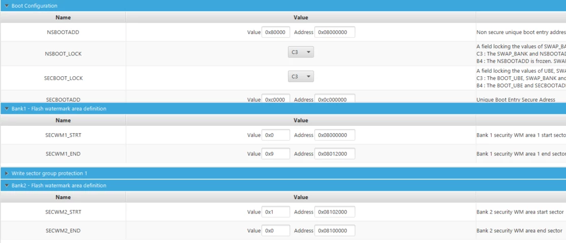

So far it works. My application requires me to use 80K of memory in the secure zone and 1968K of memory in the non-secure zone, as I will show below:
MEMORY
FLASH (rx) : ORIGIN = 0x0C000000, LENGTH = 72K
FLASH_NSC (rx) : ORIGIN = 0x0C012000, LENGTH = 8K
MEMORY
FLASH (rx) : ORIGIN = 0x08014000, LENGTH = 1968K

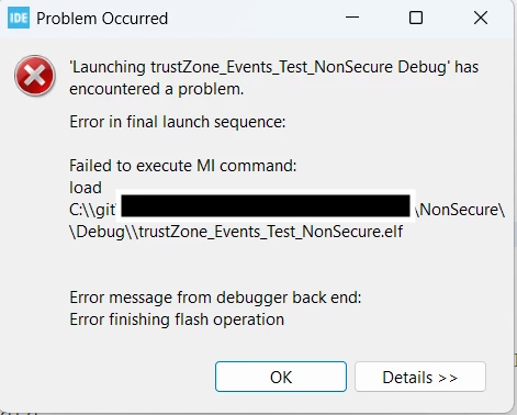

And when I try to run the application I get this error:
I'd like to know where I'm going wrong, and also ask a question: if I define the range of safe and unsafe FLASH in option bytes, would it be necessary to modify the linker?
