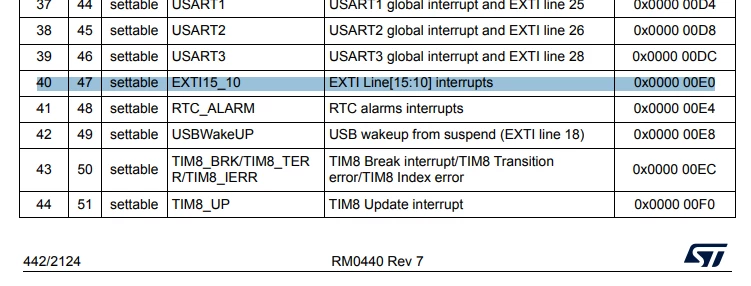

Is it possible to disable a specific GPIO interrupt in my code and re-enable it after some time. HAL_NVIC_DisableIRQ(EXTI4_15_IRQn) this function will help but this will disable all the GPIO pins connected to that particular EXTI line. Any other possible ways I can implement?

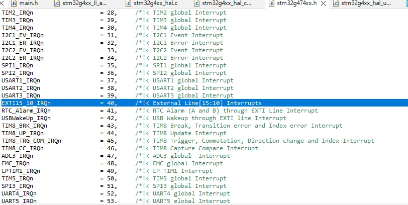

    I am using STM32G474RCT6 controller.
    Should I need to make changes in the EXTI_IMR register. Or are there any HAL functions I can use to Implement this. Currently I could be able to disable EXTI15_10_IRQn which disables all the GPIOs connected to this line.

    Hello @Sri_Nishanth
    According to the reference manual, EXTI line dedicated to 10->15 are regrouped in one vector in NVIC controller. So, using CMSIS, this should not be possible. Maybe, we can implement this operation in HAL driver using directly EXTI_IMR. I will forward the request to dedicated team.
