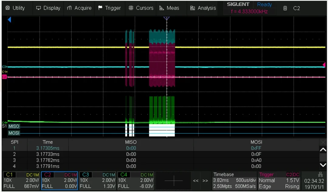

GPDMA in Linked List with OCTOSPI
Hi all !
I'm trying to write a driver for a LevelX system to talk to a QSPI chip over the OCTOSPI1 peripheral (STM32H563). I got the chip to respond to most commands, set it up in reading / protected mode.
But, later, I've spotted an issue : I cannot sent over DMA two buffer, one after the other (as I did, two call to the Transmit_DMA function). Or, the LevelX API provide me two buffer, that may not be contigous. That's the issue, how to do ?
I reminded that this chip has Linked List functionnality, which does match what I want (two DMA transfer from / to two different memory space, but, within one frame (Only one NCS being low).
And, I cannot find a way to make them work...

What I'm getting for now is that screen (large timebase, show all from reset). In theses IO, flash is working as QSPI, so, exact values decoded by the scope are irrelevant).
[ image linked in attachements ]
1st block : configuration commands.
2nd block : polling to wait until ready. (In that case, waiting for the page to be loaded).
There shall be a third block for the transfer, which... is not happening. And, I don't know why.
Examples from ST are using the same function call, shall be working for them, and, not mine.
To be noted : I must send the command bytes somewhere, so, I must call the HAL_XSPI_Command(...) somewhere. But, how to fire the linked list GPDMA engine ? And, sync the OCTOSPI peripheral ? That's the question.
Thanks for any help ! I'm struggling on that point for the last 10 days, starting to be long...

Hello @lheywang
ST OCTOSPI example in STM32CubeH5 is using DMA in normal mode not linkedlist.
