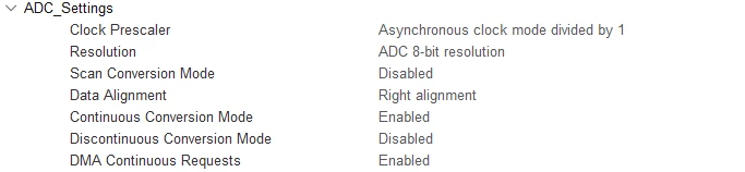

I have an ADC input that is read continuously and put in a buffer by the help of DMA. This is my buffer:
uint16_t adc_buf[ADC_BUF_LEN];        //ADC_BUF_LEN = 1
The value in the buffer is replaced continuously by the NEW sampled value from the ADC.
I want to use this value in the buffer, so how can I get out the value. I was thinking something like this:
int value = add_buf[0];
and then I can use the variable "value" for stuff, like printing it to the terminal on my computer or do calculations. But how do I do this? I am not able to print the value to the serial terminal on my computer...

    A simple way to code the behaviour you wanted.
    /* USER CODE BEGIN PD */
    #define ADC_BUF_FULL_LEN 4096 //65535 is max due to DMA buffer limitations
    /* USER CODE END PD */
    /* USER CODE BEGIN PV */
    uint8_t adc_buf[ADC_BUF_LEN]; //Or uint32_t, uint16_t etc. depending on your ADC data.
    volatile bool adc_buf_half_full = false;
    uint8_t wtext[10];
    /* USER CODE END PV */
    /* USER CODE BEGIN 2 */
    HAL_ADC_Start_DMA(&hadc3, (uint32_t*)adc_buf, ADC_BUF_LEN);
    while(!adc_buf_half_full); //Wait for interrupt
    sprintf(wtext, "Data: %u", adc_buf[0]);
    HAL_UART_Transmit(&huart3, (uint8_t *)wtext, strlen(wtext), 1000);
    /* USER CODE END 2 */
    /* USER CODE BEGIN 4 */
    void HAL_ADC_ConvHalfCpltCallback(ADC_HandleTypeDef* hadc){
     adc_buf_half_full = true;
    /* USER CODE END 4 */
     Some important configs:
    Hope this helps!

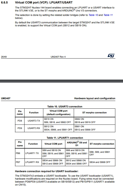

    Hi HØdeg.1,
    To write to serial port you can find the datasheet of your board. Lets say you have a STM32H7XX nucleo-144 board then USART3 is the port you want to configure to use the USB cable of your nucleo-144 board.
    For Nucleo-144 H7 boards:
    https://www.st.com/resource/en/user_manual/um2407-stm32h7-nucleo144-boards-mb1364-stmicroelectronics.pdf
    Then go to this chapter:
    Then you will see this:
    Here you can see that USART3 TX and RX configured to pins PD8 and PD9 will let you send data using the function HAL_Uart_transmit().
    If you open something like PuTTy you can then read the data you send.
