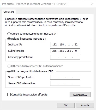

I set on the PC a static ip as follow:
Then, I expect, when connecting the board to the PC something to show up in the AUTOIP ip range: 169.254.x.y
But.. "arp -a" don't show nothing...

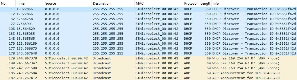

Thank you both for you answers, LCE for pointing out this wonderful solution to the no-dhcp problem (I'm working for Automatic Test Equipments who are big racks full of instrumentation connected via LAN to a PC, everithing is set as static ip and no dhcp server is present), and Pavel to get me back to a lower level debug: the AUTOIP function is working flawlessly, it has always been. Let me explain with a Wireshark dump:
Look the 9 "LWIP_DHCP_AUTOIP_COOP_TRIES", look the 244 seconds (!!!) needed before the AUTOIP take place after the DHCP discover and broadcasts an arp probe with the pseudo generated ip. It was just taking too much time, I wasn't discovering it in the pc arp table because I was checking it too early.
Changing in STM32CubeIDE I've flagged:
Key Options > IPv4 - AUTOIP Options > LWIP_DHCP_AUTOIP_COOP_TRIES (DHCP AUTOIP Coop Tries) > 3
I can easily get, after just 10 seconds, the target ip in the command line "arp -a" answer.

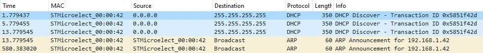

I hooked the code right after the (disabled) section of where would start the autoip function, catching the dhcp re-tries, setting the static ip (forgive me the hard coded values, I'll change to memory stored one in the final code), stopping the dhcp.
As you can see below, it works as expected (rown1-4), I'm still working on it because I want to DHCP run again when disconnecting and reconnecting the cable, actually stick again on the static IP (row 5) without a new dhcp attempt. :\ Any hint?
