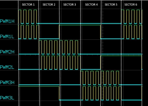

Hello everyone,
I’m interested in electric motor drives and power electronics. I’m trying to create a C program for STM32F407 Discovery board that executes Hall sensored 6 step commutation with complementary PWM.
The program must apply a PWM signal to the high side mosfet, complement of this pwm signal to same leg low side mosfet with significant dead time and GPIO-ON State to corresponding low side mosfet according to Hall sensor state. You can see what I’m trying to do in the figure below.
I set the GPIO pins to alternate function to generate PWM and did necessary configuration to generate complement of this PWM signal. But I’m confused. For instance at sector 1, I generated both PWM signals and control the PWM3L via GPIOx->ODR register. But at sector 4 I need to apply PWM signal for the same pin(PWM3L). Do I need to configure the pin as output or alternate function? How can I configure this? Do I need to use event or interrupt. Can anyone help me please? Thanks in advance. I leave the program that impelement complementary PWM signal with 8us dead time.
