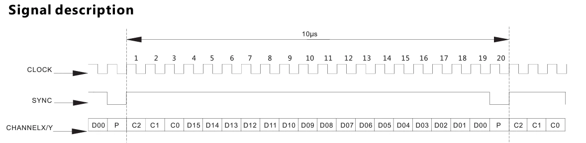

We want to develop a protocol called XY2-100. Here's a description of the protocol:
https://dvd.ilphotonics.com/Ray-Motion%20-%20galvanometers%20-%201D-2D-3D%20scanners/Motion%20Control%20-%20Optomechanics/Interface%20XY2-100.pdf
The protocol consists of four signals: Clock, ChannelX, ChannelY, Sync.
  • The data of each axis consist of 20-bit words.The first 3 bits are used as a control word(C2-C0).The next 16 bits are data information(D15-D0, offset binary) and the last bit is a parity bit(P, even parity).
  • The clock signal runs at a frequency of 2 MHz.When it goes high,the data bit changes.When it goes low,the data bit is sampled by the deflection system.
  • The transfer of data is synchronised using a synchronisation signal.The SYNC bit goes high when the first bit can be sent. It remains high for 19 bits and goes low when the parity can be sent.

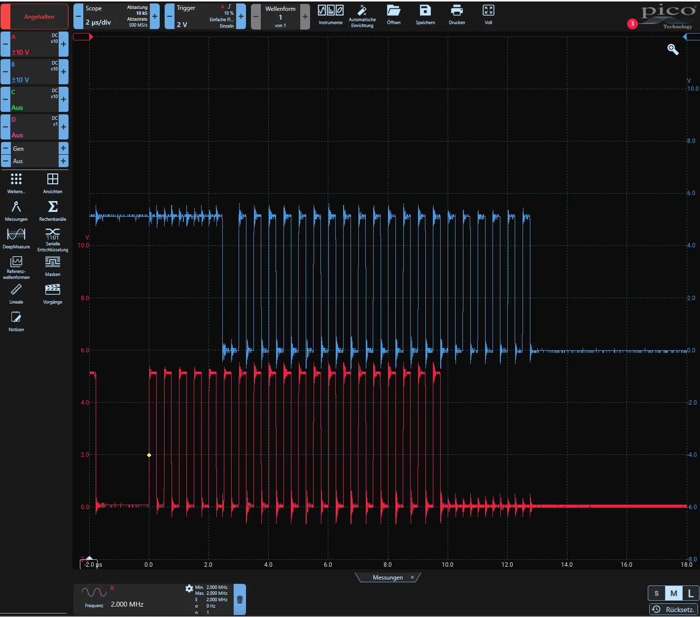

I observed these signals:: red TIM_CHANNEL_3; blue TIM_CHANNEL_4
The clock of 20 periods, which is what is stored in chx_buf, works perfectly and the channel_4 generates the same signals but it starts around 2ns later, which would be a problem.

  1. Is it possible to generate the XY2-100 protocol with timers, PWM_DMA, and synchronization as described in the definition?CObri1_0-1708965451543.png
  2. If yes, do I have to use 4 different timers, or can I use one timer with 4 channels, as I did in my test?
  3. Is there an example of generating more than one signal and synchronizing these signals?
  4. Would it make more sense to "bitbang" the protocol (using all the CPU power)?
Best regards, Corsin
