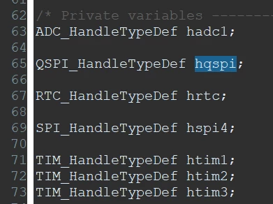

In the generated code in main.c file, there are variables that are declared as "private variables" by the software, such as "ADC_HandleTypeDef hadc1"; "TIM_HandleTypeDef htim1". Since these variables are declared only in main.c and not in main.h, does that mean that the use of these variables in other modules is not encouraged?
If I need to use them in other modules, can I declare these variable as extern in main.h or is there a better way to handle this?

@neel1311 wrote:
In the generated code in main.c file, there are variables that are declared as "private variables" by the software, such as "ADC_HandleTypeDef hadc1"; "TIM_HandleTypeDef htim1". !
Please show that code.
See: How to insert source code.
In the C language, variables (and functions) defined at file scope are public unless specifically qualified as static

That comment is actually misleading.
As noted above, the hadc1 definition there is public - because it is not qualified as static.
So, as @Karl Yamashita said, you can provide your own extern declarations anywhere you want to use it - either in your own header file, or in a USER section of one of the auto-generated headers.

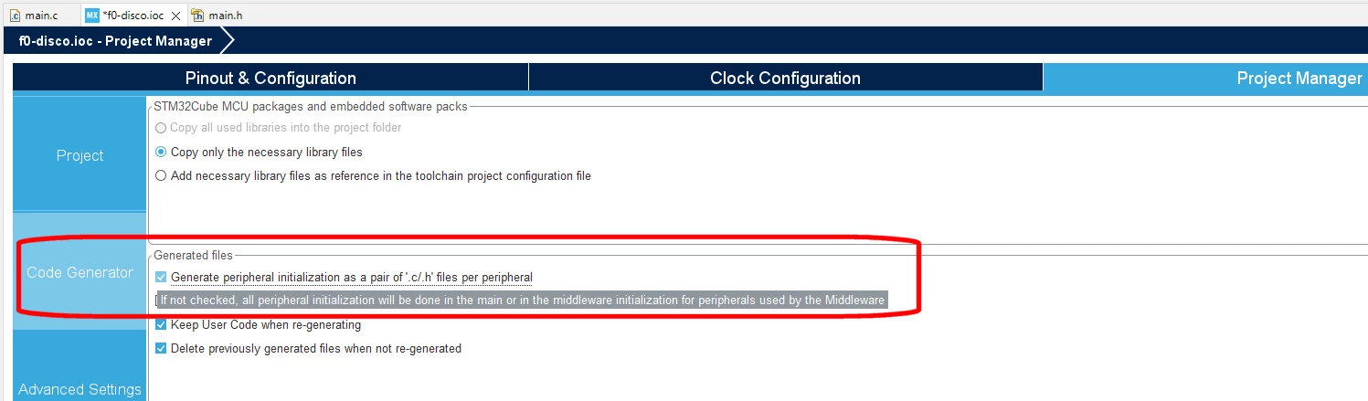

If you configure the project to generate separate .c & .h files for peripheral initialisation:
The extern declarations for the peripheral handles will be in the generated headers; eg,
#include "main.h"
/* USER CODE END Includes */
extern ADC_HandleTypeDef hadc;
/* USER CODE BEGIN Private defines */
/* USER CODE END Private defines */
