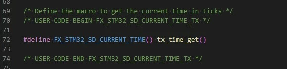

"Generate Code" adds ThreadX code when trying to generate FileX standalone project
Setting the FX_STANDALONE_ENABLE flag should disable all ThreadX specific code when building a FileX project. However there is actually some code related to ThreadX timers that is generated within a USER CODE section, defining the FX_STM32_SD_CURRENT_TIME. Does anyone know why that may be, and more importantly what would be the correct definition of this macro without ThreadX?

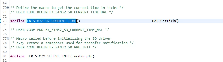

Hello @HDøss.1
Actually I tried to reproduce the issue mentioned above using the latest version of CubeMX 6.8.0 and this is what I got please have a look
0693W00000aIplDQAS.pngThx

Hello @HDøss.1
Ghofrane
