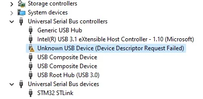

I struggled already two days with the implementation of USB_OTG_FS on a STM32F401 board. The most prominent error concerns the Virtual Com Port on the Windows PC: whatever I try, there is always a message saying "USB device not recognized", with as addition "Device Descriptor request failed".
In a final attempt I stepped my debugger through the initialization process and encountered the function 'USB_DevConnect(...)', located in the file: "ProjectName>>Drivers>>STM32F4xx_HAL_Driver>>Src>>stm32f4xx_ll_usb.c", line 76. I considered the statements in that function a bit strange, until my eye fell on the function 'USB_DevDisconnect(...)' right below the former one. The body of both functions are exact copies of each other!
At first I thought I messed up this file myself, so I checked the "master" file in the Repository for STM32F4xx targets, with the same result. Still I couldn't believe this came from ST, so I downloaded the most recent version, the "STM32Cube_FW_F4_V1.28.0" repositry, unzipped the file and checked the content of "stm32f4xx_ll_usb.c". Also here the problem appeared present in 'USB_DevConnect(...)', so I have no way to correct......
I sincerely hope ST will read about this flaw and file it on their "to-do-list". I assume it will not cause an emergency update release, but it will be very helpfull when a "repaired version of the file 'stm32f4xx_ll_usb.c' will be available soon.

I am not sure what you are seeing because according to the latest code found on the public github repo
The functions are not identical, one is setting the soft disconnect (SDIS) while the other is clearing it.

Hallo Eddie,
My sincere apologies for spoiling the bandwith and taking some of your time. You are completely right, the last statements in each function are NOT identical and do as you pointed out.
I will redo my debugger stepping to detect which action produces the "USB device not recognized" message and report my experience.

Hallo Eddie,
I just have tried to get a project running on a STM32F401RCT6 board that just should output the values of an uint16_t array by USB_OTG_FS , configured as VCP device. I started the built-in 'serial wire' debugger and stepped through all relevant statements of the main function 'MX_USB_DEVICE_Init()'. When I arrived inside the function 'USB_DevConnect(...)', the execution of the second statement (USBx_DEVICE->DCTL &= ~USB_OTG_DCTL_SDIS;) caused the windows popup "USB device not recognized".
In the Windows Device Manager I identified the related USB device, see:DeviceManager_USBerror_.jpg
As this project only contains the USB_OTG_FS and a small piece of code that produces the data-array to be exported I am stuck. The application seems to run in the main 'while(1)' as designed, except the fact the function 'CDC_Transmit_FS(....)' doesn't do anything because the OTG status is 'HAL_BUSY'.

I will try to replicate with a Nucleo-F446RE. Get back to you then. In the meantime can you tell me what board specifically.

I banged into same issue with with my F103 after update to Cube IDE 1.15. Seems like autogeneration sucks.
This is what I got:
static void Get_SerialNum(void)
 uint32_t deviceserial0;
 uint32_t deviceserial1;
 uint32_t deviceserial2;
 deviceserial0 += deviceserial2;
 if (deviceserial0 != 0)
 IntToUnicode(deviceserial0, &USBD_StringSerial[2], 8);
 IntToUnicode(deviceserial1, &USBD_StringSerial[18], 4);
And here's how IT SHOULD BE:
 deviceserial0 = *(uint32_t *) DEVICE_ID1; // Missing
 deviceserial1 = *(uint32_t *) DEVICE_ID2; // Missing
 deviceserial2 = *(uint32_t *) DEVICE_ID3; // Missing
