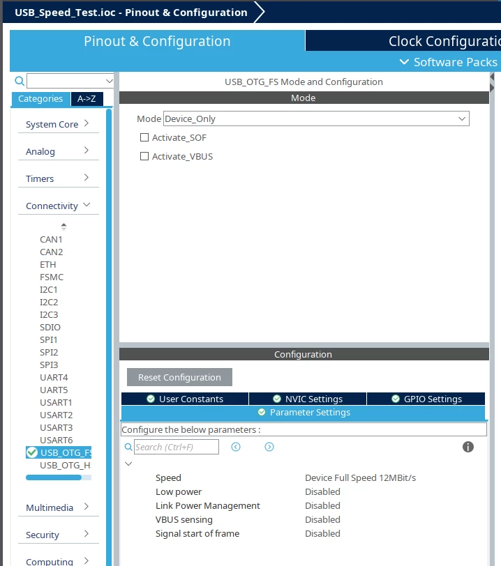

I'm trying to test out Full Speed USB Communication with the STM32F407 DISCOVERY board.
I'm sending 1 MB of data to the serial port of the computer and receiving them and saving the data using a python script. The speed I'm getting is close to 350 kB/s (~0.34 MB/s), but USB FS theoretical speed is 1.2 MB/s. Is there a way to increase the speed or am I doing something wrong to get such a lower speed?
In the clock configuration, HCLK is 168 MHz (max) and PLLQ is set to 7, giving a 48 MHz USB clock.

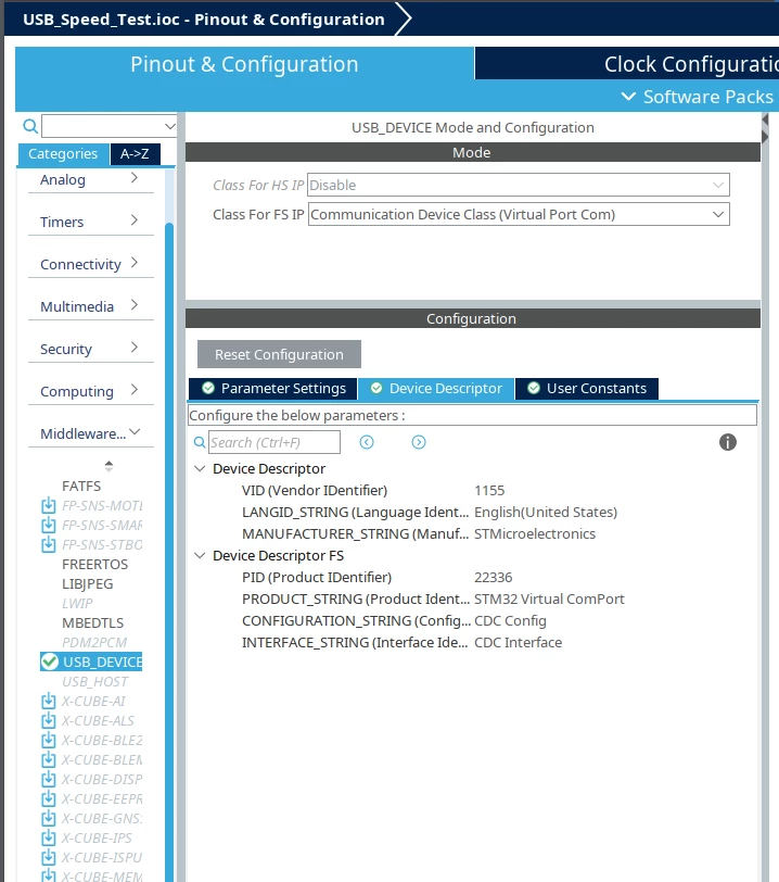

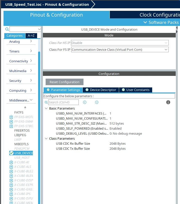

I have attached pictures of the changed configuration from Cube MX.

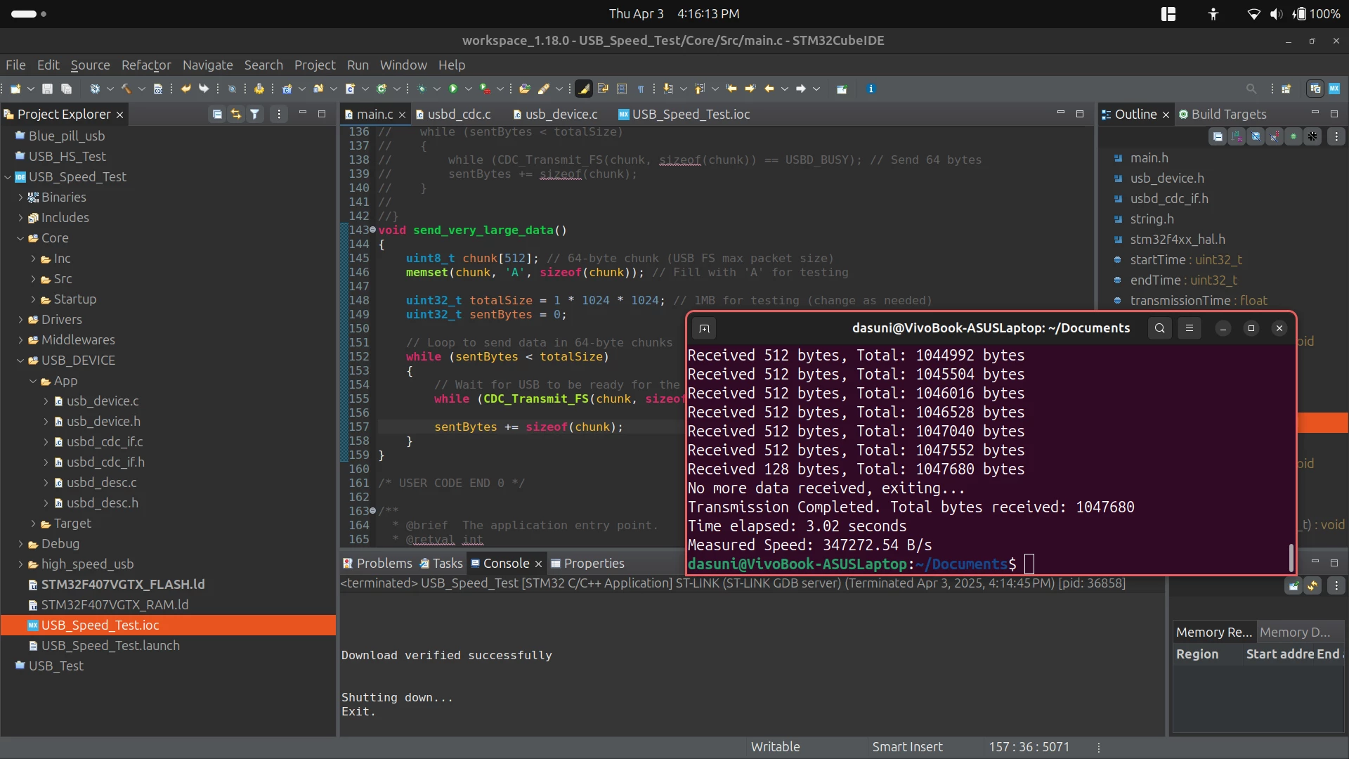

This is the Python script I'm using to receive the data from the USB port and calculate the speed.
import serial
import time
PORT = "/dev/ttyACM16"
BAUD_RATE = 115200 # Required by PySerial but ignored for USB CDC
OUTPUT_FILE = "received_data.txt"
def receive_data():
try:
with serial.Serial(PORT, BAUD_RATE, timeout=1) as ser, open(OUTPUT_FILE, "wb") as file:
print(f"Listening on {PORT} ...")
received_bytes = 0
start_time = time.time() # Start timing before first read
while True:
data = ser.read(512) # Read USB FS max packet size (64 bytes)
if data:
file.write(data)
file.flush()
received_bytes += len(data)
print(f"Received {len(data)} bytes, Total: {received_bytes} bytes")
else:
# No data received (timeout), exit the loop
if received_bytes > 0:
print("No more data received, exiting...")
break
end_time = time.time() # End timing after the transmission
elapsed_time = end_time - start_time
print(f"Transmission Completed. Total bytes received: {received_bytes}")
print(f"Time elapsed: {elapsed_time:.2f} seconds")
print(f"Measured Speed: {received_bytes / elapsed_time:.2f} B/s")
except serial.SerialException as e:
print(f"Error: {e}")
if __name__ == "__main__":
receive_data()
These are the speeds I got.
First attempt: 358936.70 B/s
Second attempt: 359011.95 B/s
Third attempt: 359060.76 B/s
Fourth attempt: 363372.03 B/s
Fifth attempt: 358888.39 B/s
Visitor II
April 21, 2025
Maybe try increasing the USB FIFO buffer
