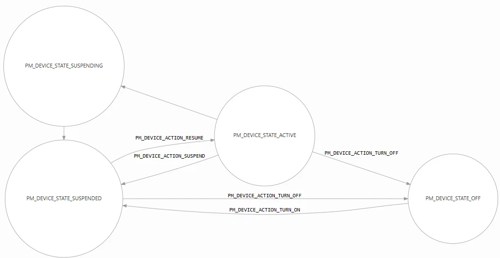

Since our application needs to go low power, we would take advantage of Zephyr Power Management (Device Runtime Power management):
Thank you,
Alessandro
Apr 15, 2025 9:58 AM UTC
Hello @ALong.4,
The STM32U5 series is PM aware, but we don't have such a list, you'll have to check for the peripherals you're going to use!
Regarding the power states, they are defined by pm_device_state. In general power states with higher indexes will offer greater power savings and have higher wake latencies.
These are the device states:
and the default state depends on the soc/board configuration, you can customize your board config to add/ delete some stop modes and transition from a mode to another after reaching the residency value!
