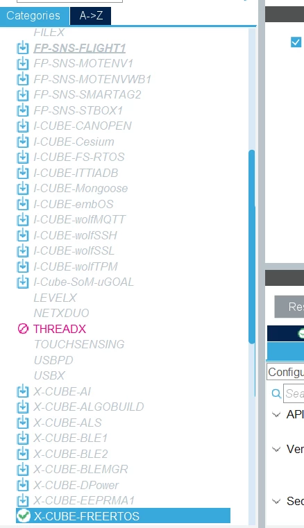

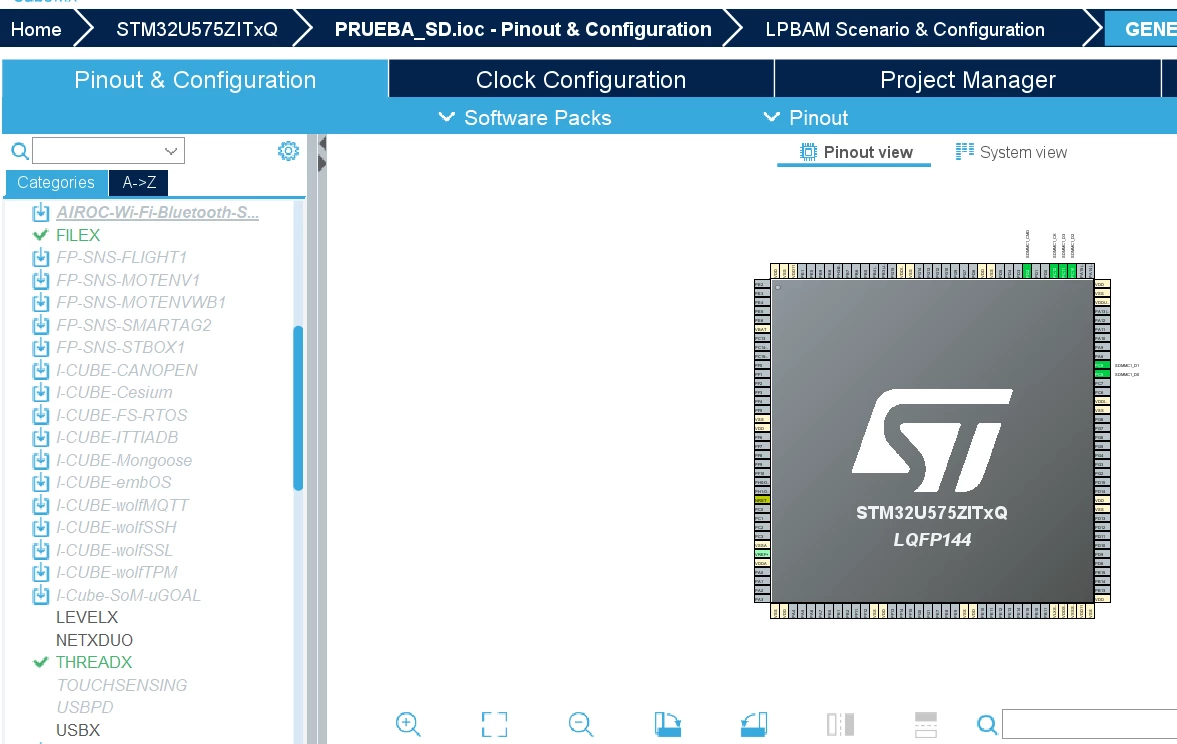

I say that because, when I try to configure my board on STM32Cube, FILEX(for using the SD) is avaiable if I choose ThreadX, but not with FreeRTOS.

That's not a limitation of SD itself.

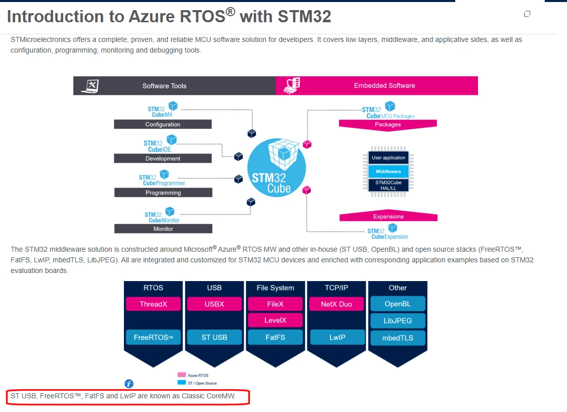

That's because FileX is part of the ThreadX (formerly "Azure RTOS") suite;
For FreeRTOS, FatFS was used as the filesystem component:
https://wiki.st.com/stm32mcu/wiki/Introduction_to_Azure_RTOS_with_STM32
The New Direction is now to integrate FileX with FreeRTOS:
https://community.st.com/t5/stm32-mcus-embedded-software/freertos-replacing-threadx-as-the-main-kernel-may-2025-stm32/m-p/802616/highlight/true#M63432
But they haven't done that yet.
