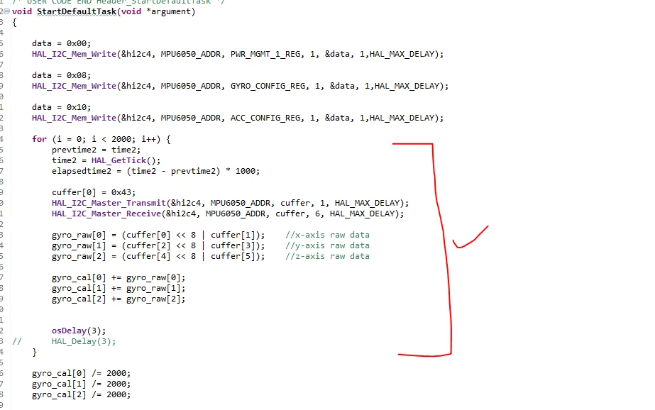

Why the task keep running and remain of infinite loop, and do not enter another function ?

I don't know why it keep remain at first loop only.
Could you please help to see whats wrong with this code.

its got stuck at this loop and do no enter into another function

And your definition of i is so precious you can't share it.
My wild guess: either the i variable is used by some other code (I don't understand why you didn't declare it in the for statement), or it's declared as 8-bit, like uint8_t.
In the latter case the compiler issued some warnings and you ignored them, which is defnitely not a good practice.

okay i have change i into local variable but it still remain execute at this loop. Could you help to see whats wrong with these code? What i missing or wrong ? i attached the code
