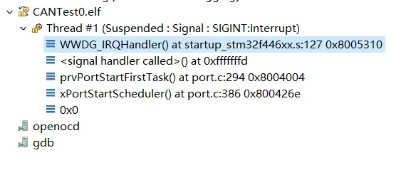

I am a beginner in both STM32 and FreeRTOS. I tried writing a FreeRTOS program logging ADC reading through serial port. I have a DMA set-up to save ADC readings in an circular buffer array, and I also have a DMA set up for serial port. Meanwhile, I have another thread running to blink a LED through PWM using timer 12, and another defaultTask doing nothing. The board is STM32F446RE nucleo, and the initial code was generated using STM32Cube.
The part of code with modification is shown below:

For some reason, the code stops around 10 seconds. I have tried several things:
  1. Increasing the delay amount seems to make it goes away.
  2. Whether the memory is statically or dynamically allocated does not seem to change it.
  3. I have logged the TaskList. Right  before it crashes, the stack watermark will suddenly go very low, and task name got corrupted somehow. (The code I post above have those parts commented because I am currently trying static memory, which does not support vTaskList)
  4. when it crashes, it goes here:
I don't know what is wrong with this arguably simple code. But I am a student really new in this, and would really appreciate any help.

I found this post which seems to be related to my issue.
https://www.freertos.org/FreeRTOS_Support_Forum_Archive/July_2013/freertos_vTaskDelay_250_causes_a_Hard_Fault_..._8516990.html
I do observe corruption of the default task when I debug this application, which seems to agree with what the post mentions.
So I increase stack size of all the tasks to 1024 words and now it seems to works fine.
But still I am not understanding this issue. Could someone please explain what is going on? Why is the stack of the default task that becomes relevant? And is this the right way to solve this issue?
