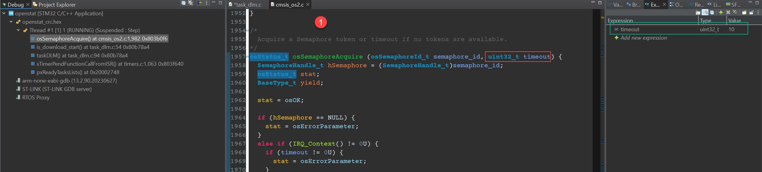

Hey everyone, I’ve identified the root cause of the issue when using optimization -O2 with the CMSIS-OS API. After stepping through the code, here’s what I found:
  1. Calling osSemaphoreAcquire with a timeout of 10 ms works fine. No issues at this stage.

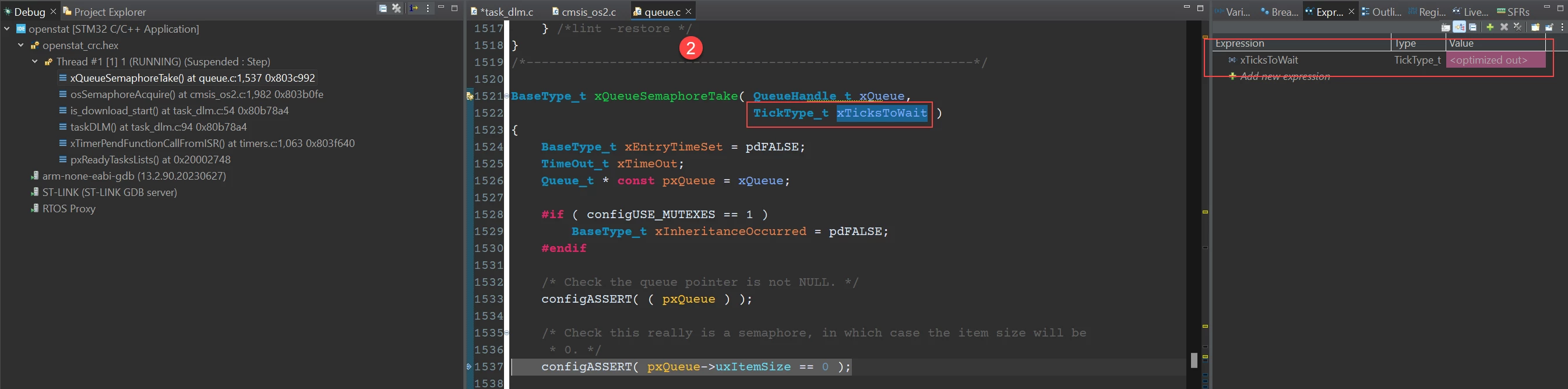

  2. osSemaphoreAcquire then calls xQueueSemaphoreTake. In this function, the xTicksToWait parameter seems to be optimized out in the debugger, and I’m unable to view its value.

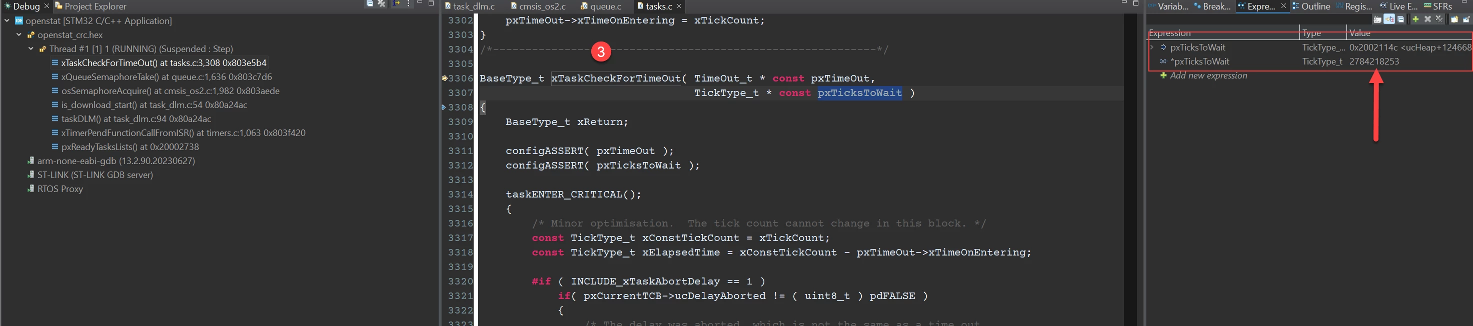

  3. The real problem arises when xQueueSemaphoreTake calls xTaskCheckForTimeOut, passing the xTicksToWait pointer as the second argument.
Here in xTaskCheckForTimeOut, the debugger shows a completely unreasonable, huge value for *pxTicksToWait. This clearly causes issues because this value is used to calculate the remaining ticks before the timeout:
My workaround
To make it work, I introduced a volatile variable xCopyOfTicksToWait in the xQueueSemaphoreTake function to store a copy of the value of xTicksToWait.
// queue.c
BaseType_t xQueueSemaphoreTake( QueueHandle_t xQueue,
 TickType_t xTicksToWait )
 BaseType_t xEntryTimeSet = pdFALSE;
 TimeOut_t xTimeOut;
 Queue_t * const pxQueue = xQueue;
 volatile TickType_t xCopyOfTicksToWait = xTicksToWait;
 #if ( configUSE_MUTEXES == 1 )
 BaseType_t xInheritanceOccurred = pdFALSE;
 #endif
 /* Check the queue pointer is not NULL. */
 configASSERT( ( pxQueue ) );
 /* Check this really is a semaphore, in which case the item size will be
 * 0. */
 configASSERT( pxQueue->uxItemSize == 0 );
 /* Cannot block if the scheduler is suspended. */
 #if ( ( INCLUDE_xTaskGetSchedulerState == 1 ) || ( configUSE_TIMERS == 1 ) )
 configASSERT( !( ( xTaskGetSchedulerState() == taskSCHEDULER_SUSPENDED ) && ( xCopyOfTicksToWait != 0 ) ) );

So, why is the original xTicksToWait in xQueueSemaphoreTake getting corrupted by the compiler?
