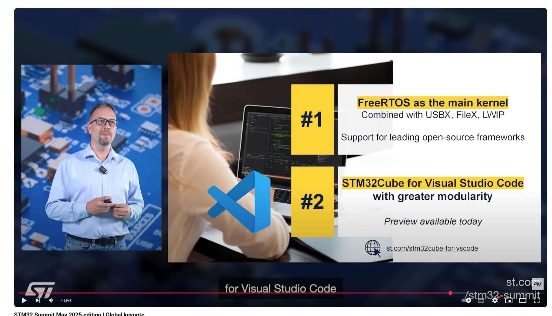

On the keynote speech, I saw that FreeRTOS will be the main kernel.
  • Does that mean that ThreadX will not be offered as an alternative?
  • What is the reason for this change?
  • What about NetXDuo as a middleware?
I am quite happy with how ThreadX and its components worked with each other. Over the years, I have developed several products with NetXDuo, USBX middlewares with ThreadX as an operating system. Not sure why ST is stepping back to FreeRTOS. Curious to know.

Ah - this has just appeared: New strategic directions for STM32Cube by @Maxime_MARCHETTO:
Transition to FreeRTOS and enhanced middleware offerings
We are moving back to FreeRTOS™ as the main kernel, integrating it with USBX, FileX, and LWIP. This strategic shift will help us build a consistent middleware offering, set to be introduced before the end of this year. Notably, USBX and FileX will be available in both bare metal and RTOS-agnostic versions, providing greater flexibility and adaptability for your projects.
