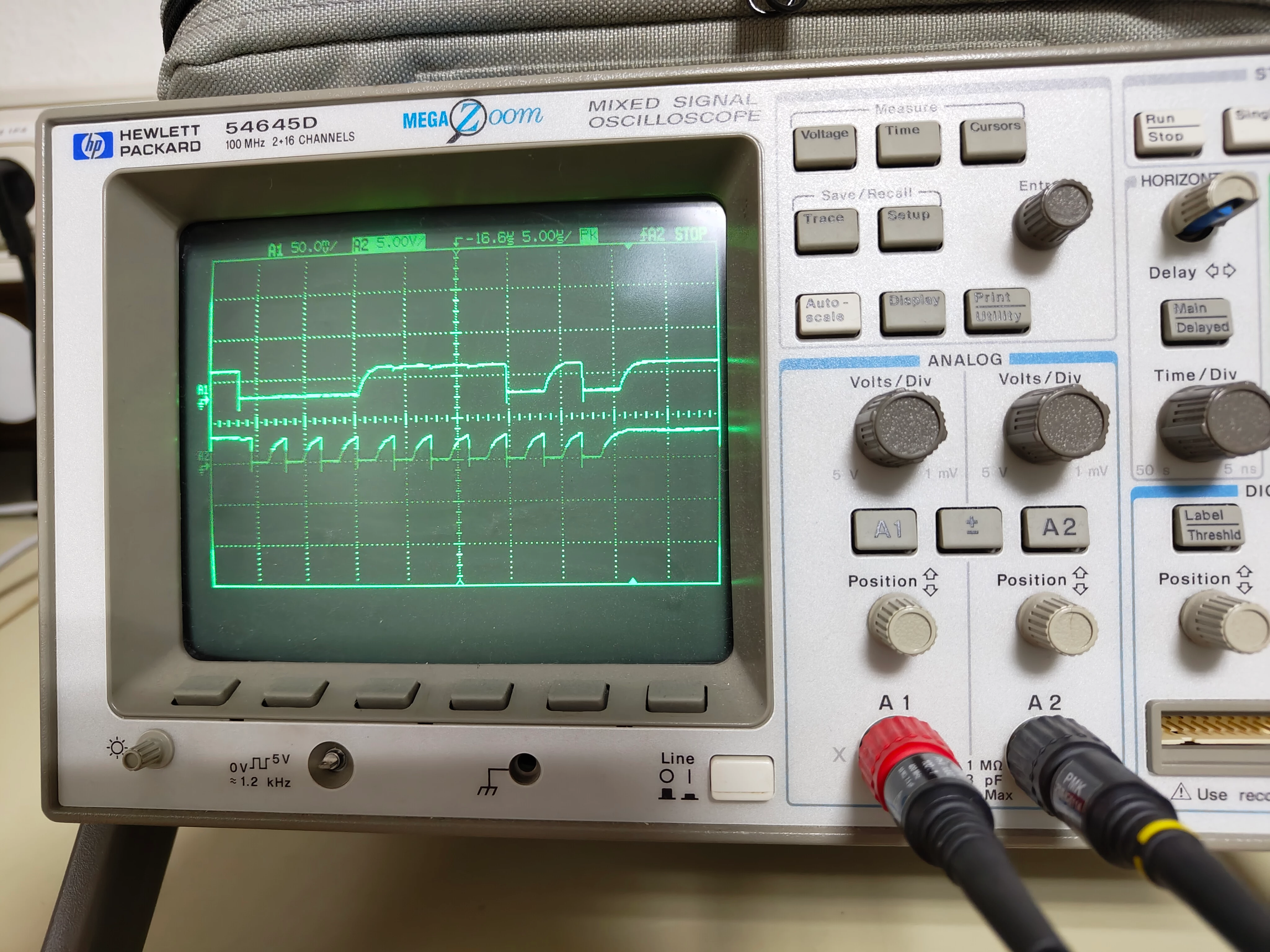

I have two Nucleo boards STM32G071RB that I have written an I2C interface for. It is basically a command interface, where Master sends a command, and polls the slave later to get the response. I have tested my application thoroughly, it is working great between these two Dev Boards.

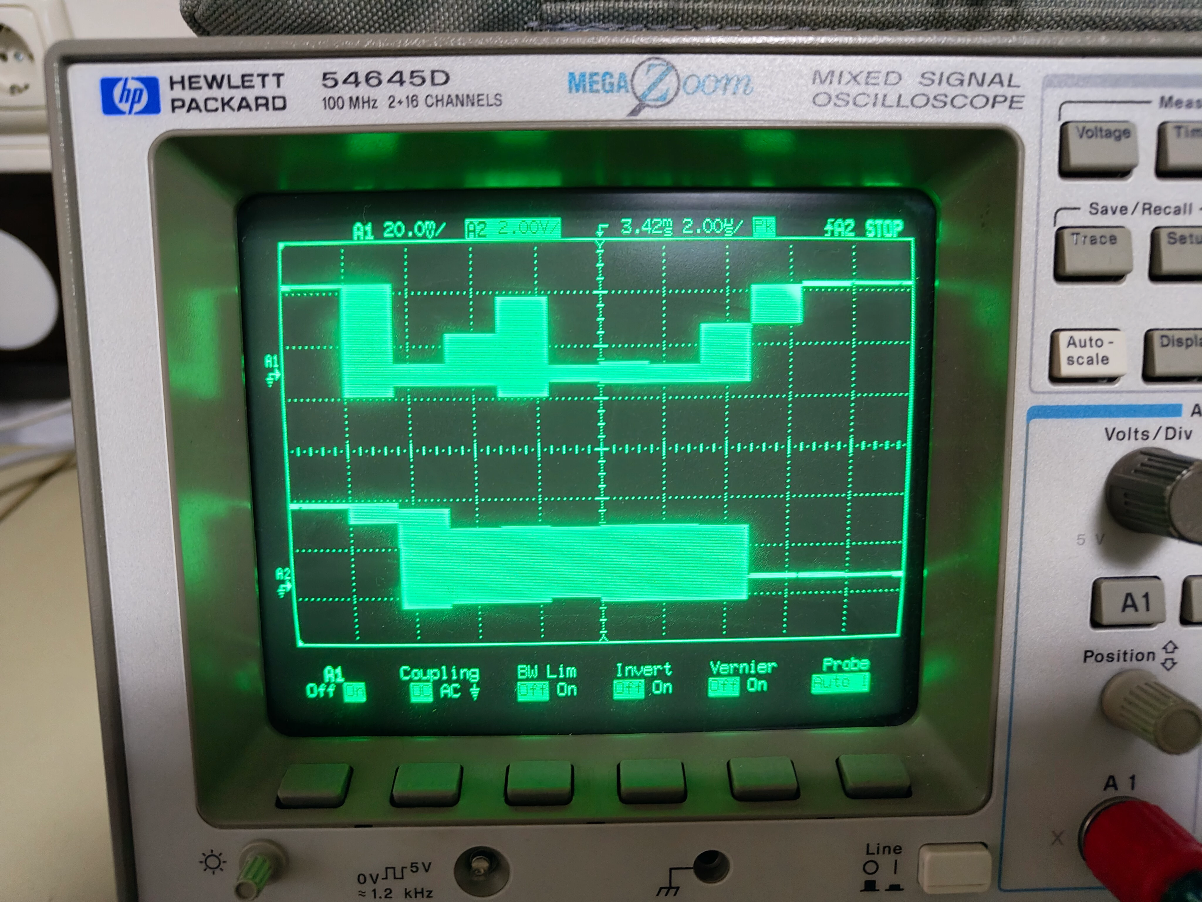

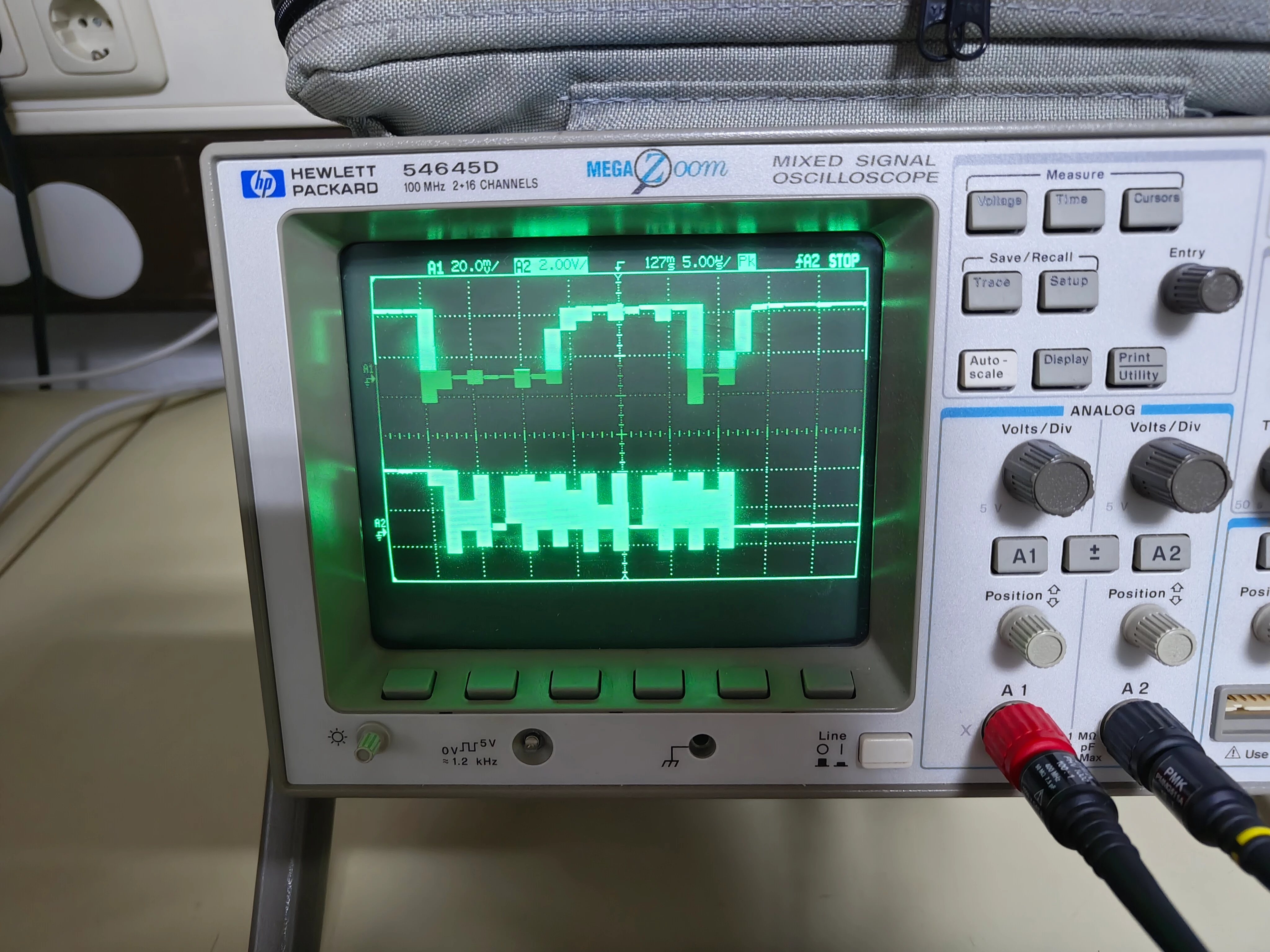

Now for the actual work, I am replacing the slave with an internally developed board based on STM32G0B1, running FreeRTOS (I am fairly new to RTOS). Between the RTOS G0B1 Slave and the G071 Master, I see the Master send the slave address; The slave reads its address and holds the clock line low permanently; It does not trigger AddressCpltCallback, allowing me to receive the data. Sometimes the Oscilloscope would show 16-20 bits on the SDA/SCL lines instead of the usual 8-9 (not sure what setting i messed with to get that), but end result remains the same, after these bits, Slave will hold the SCL low indefinitely. Any ideas where I went wrong could help, thanks.

My guess so far is that the I2C Interrupt is still disabled. Maybe I need to enable it through some RTOS function? Much thanks for your help.
In the attached images, A1 (top) is Data, A2 (bottom) is clock.
