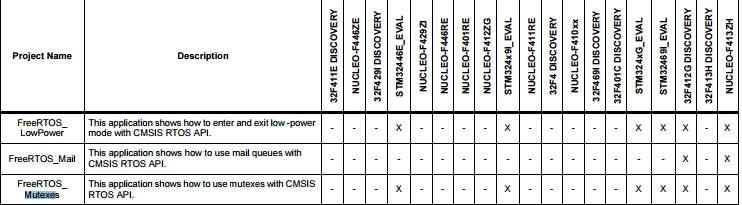

If you are using an STM32F4, the example ''
FreeRTOS_Mutexes'' is available as application example for boards marked with ''x'' in this table (extracted from
http://www.st.com/content/ccc/resource/technical/document/application_note/ca/34/db/d3/71/50/44/9b/DM002135pdf/files/DM002135pdf/jcr:content/translations/en.DM002135pdf
