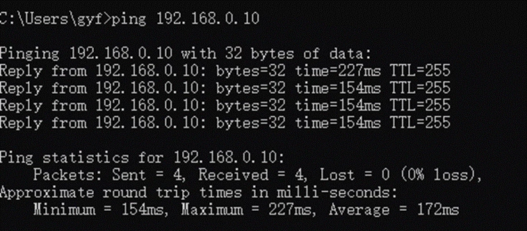

Everything's fine at this point : I can ping 192.168.0.10 and get replies.Hamaos_0-1718185156794.png

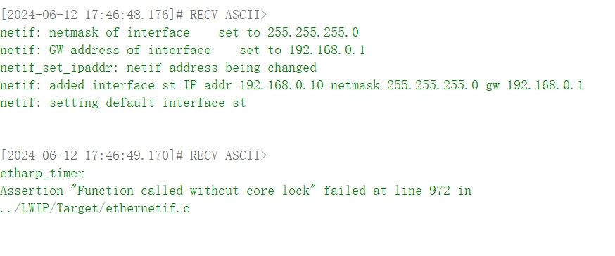

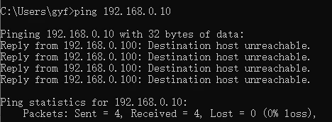

However, after I Modify the StartDefaultTask in main.c , I can't ping the device and get some debug information from uart :
How to deal with "core lock " in the debug information ?

Hello @Hamaos ,
Try to add the following:
LOCK_TCPIP_CORE(); after MX_LWIP_Init(); in the default task.
UNLOCK_TCPIP_CORE(); before your for loop
these macros and prototypes are for proper multithreading support
