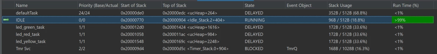

I am configuring a project from scratch for a STM32 FreeRTOS based.
From FreeRTOS documentation:
Low priority numbers denote low priority tasks.
The idle task has priority zero (tskIDLE_PRIORITY).
It is possible for application tasks to share the idle task priority (tskIDLE_PRIORITY).
See the configIDLE_SHOULD_YIELD configuration parameter for information on how this behaviour can be configured.
#define tskIDLE_PRIORITY			( ( unsigned portBASE_TYPE ) 0U )
This matches with what I can see from my project debugging:
But, I don't understant why in STM32 code, in 'cmsis_os2.h', IDLE thread priority is '1' instead of '0'.

MHoll.2
MHoll.2Best answer
Senior III
Feb 23, 2025 9:06 AM UTC
Your right if you want to use only the CMSIS V2 layer you cannot create a Task on the Idle priority..
You could use the Idle Hook, but this is also not CMSIS V2 compatible.
Or You could use the CMSIS V1 layer, I don't think that CMSIS V1 has the same limit.
P.S.: This seems to be corrected on the latest cmsis_v2.c from ARM (https://github.com/ARM-software/CMSIS-FreeRTOS/commit/9cdbe17d1b7704439a9e6a1fa50ef879eff9b913)
So ST should consider updating to a newer version of cmsis_v2.c
