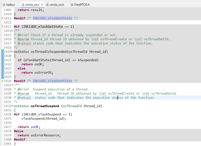

Hello Experts,

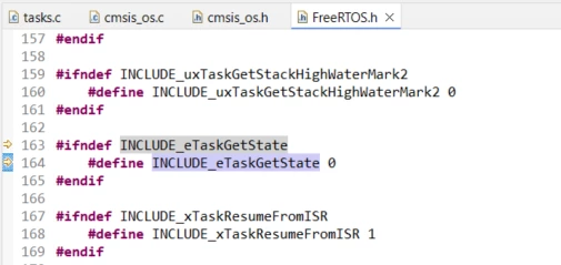

I see that in cmsis_oc.c that the function osThreadIsSuspended is disabled. The variable INCLUDE_eTaskGetState is responsible for it.
But how do we enable INCLUDE_eTaskGetState to 1 by default?
I see in FreeRTOS.h header than the macro is set to 0.
Can i just force it to 1 in FreeRTOS.h? or do we need to enable any particular config parameters in the .ioc file ?
Kindly Help!

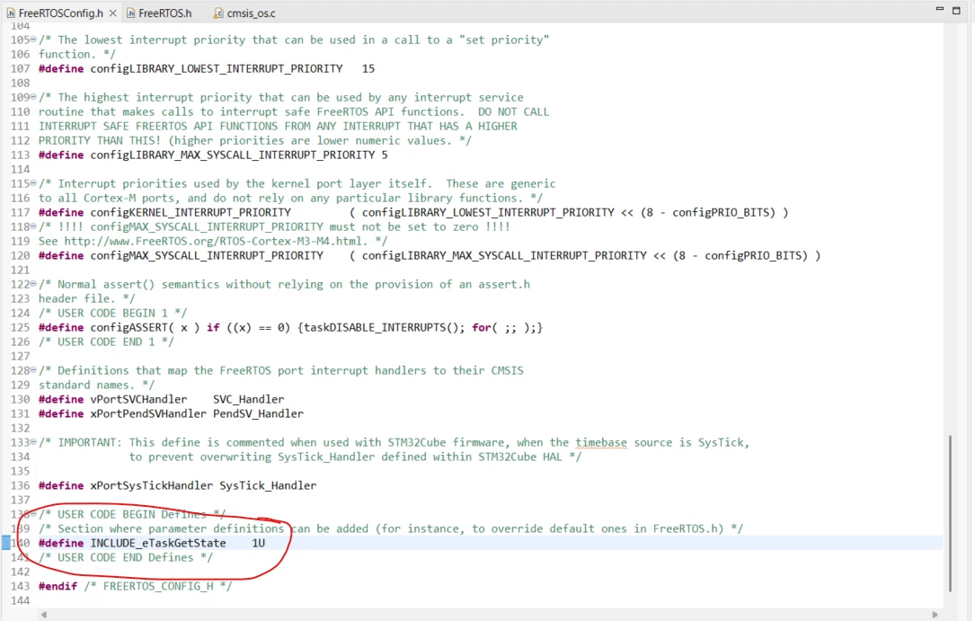

You should define INCLUDE_eTaskGetState in project file FreeRTOSConfig.h
Note that cmsis_os.c is CMSIS RTOS V1 and it would be better to use cmsis_os2.c for CMSIS RTOS V2.

I defined the macro in FreeRTOSConfig.h like this:

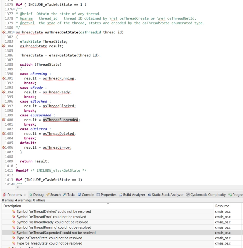

But, i get a bunch of errors related to the osThreadGetState function:
Any suggestions ?

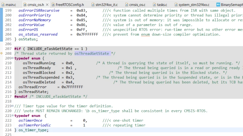

it works for me.
osThreadSuspended is defined in cmsis_os.h if INCLUDE_eTaskGetState is set to 1
check that INCLUDE_eTaskGetState is really defined to 1 in cmsis_os.h
ak52Author
May 16, 2025 1:28 PM UTC
In cmsis_os.h,  I still see INCLUDE_eTaskGetState "grayed out", even though i have it defined in FreeRTOSConfig.h  :( , I am not sure why!
