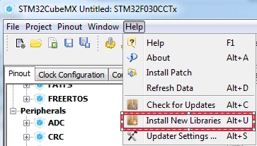

You can download the old STM32Cube firmware package from STM32CubeMx tool:
  • MENU > Help > Install New Libraries
  • Select libraries that you need
  • Force download with button ''Install Now''
