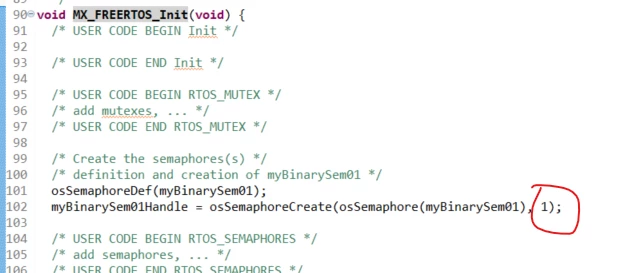

Changing the initial state of the semaphore to Depleted does nothing in the semaphore definition and creation:
In freertos.c, inside the function MX_FREERTOS_Init(). i  think the second function parameter should be zero

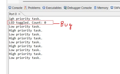

I am trying a simple GPIO interrupt to task signaling, but the task always takes a semaphore without the GPIO interrupt the first time. I have attached the complete freertos.c file for context. This is the console screenshot to highlight the bug:
I tried to manually change:
myBinarySem01Handle = osSemaphoreCreate(osSemaphore(myBinarySem01), 1);
to
myBinarySem01Handle = osSemaphoreCreate(osSemaphore(myBinarySem01), 0);

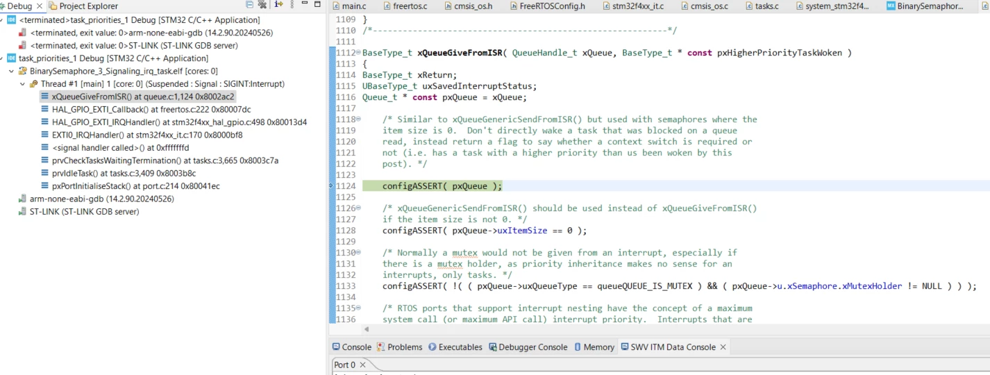

Now the task does not take the semaphore during start up, but the moment the GPIO interrupt occurs(push-button), the whole system hangs in an asset failure:
Is there any solution to this problem? I have attached my freertos.c file as well.

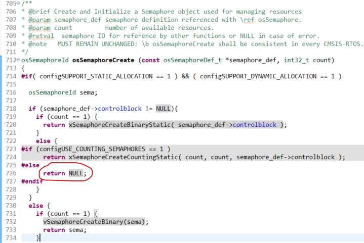

If the 2nd parameter is 0, osSemaphoreCreate likely returned NULL handle (myBinarySem01Handle ), this is why you assert in xQueueGiveFromISR. Please see the source in cmsis_os.c and you will understand.
ak52Author
May 16, 2025
Yes, thanks for pointing it out. Looking at osSemaphoreCreate  function i realized it was returning NULL.
This brings up the question how do we change the semaphores initial state to depleted/empty?
I also tried to use the native FreeRTOS APIs (xSemaphoreCreateBinary) which creates the semaphore in an 'empty' state, this worked for me, so i am pretty confident there is some issue in the cmsis implementation.

Is config_USE_COUNTING_SEMAPHORES defined as 1 ?
Maybe, change osSemaphoreCreate  like following:
 if (count == 1) {
 return xSemaphoreCreateBinaryStatic( semaphore_def->controlblock );
 else if (count == 0) {
 sema = xSemaphoreCreateBinaryStatic( semaphore_def->controlblock );
 if (!sema) return sema;
 osSemaphoreWait(sema, 0); //immediately take it
 return sema;
 else {

Thanks , you solution worked. But i used it in a different way, I did not want to modify the HAL function as it overwrites every time there is a change in the .ioc file
So i did something like this:
osSemaphoreId bin_sem_id;
osSemaphoreDef(bin_sem);
bin_sem_id = osSemaphoreCreate(osSemaphore(bin_sem), 1);
if (bin_sem_id != NULL)
 osSemaphoreWait(bin_sem_id, 0); // Take the semaphore immediately (no blocking)
 // Now the semaphore has a count of 0 and is unavailable.
