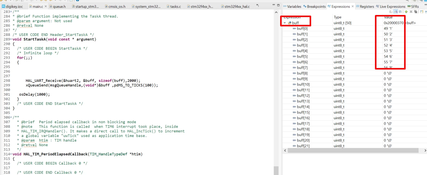

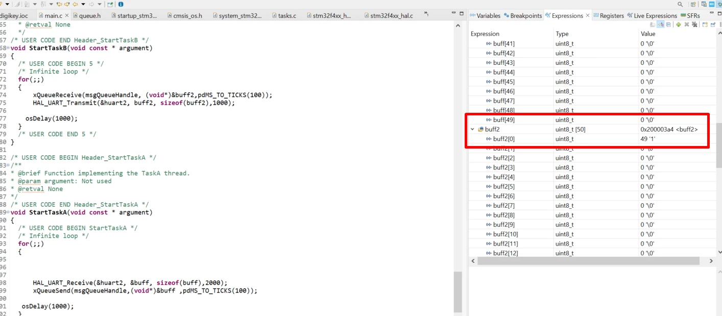

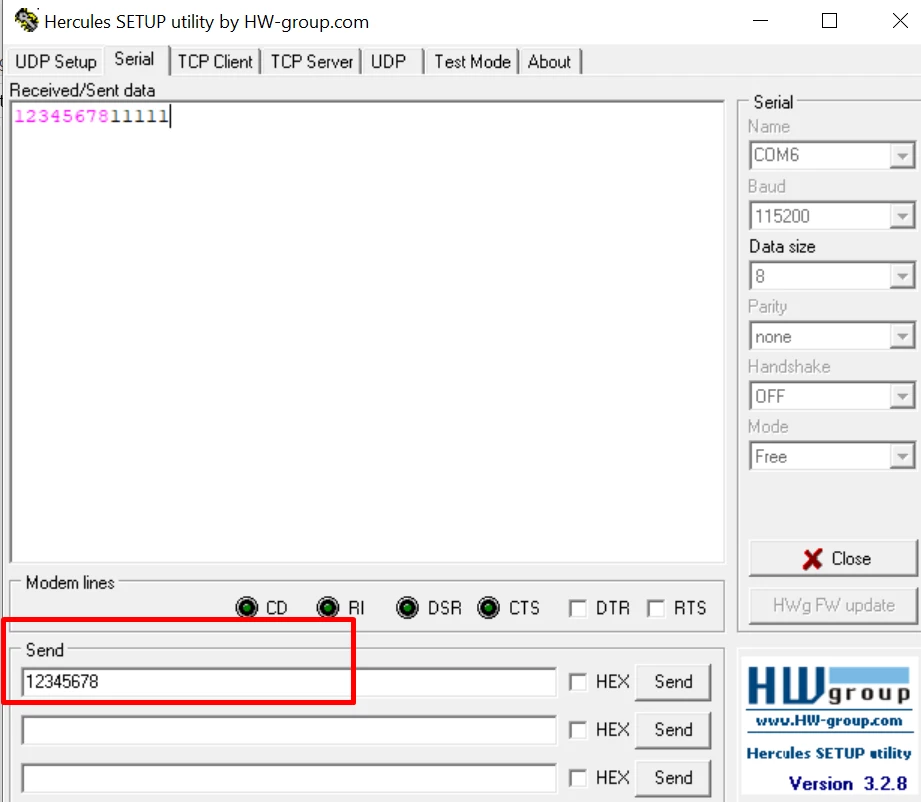

I have created two tasks. Task A and Task B. Task A has higher priority. Task receives data through UART and enques this data into queue. Then, Task A is blocked for 1 second. Task B comes into picture and dequeues the data from queue. I send 8 bytes of data, I can see that Task A writes to buff array when I send message through via serial terminal on UART.
I send buff array to the queue, then I enqueue the data from queue and write it into buff2 array. When I read the buff2 array I only see the first byte of buff array.
Please see below serial terminal output.

	 xQueueReceive(msgQueueHandle, (void*)&buff2,pdMS_TO_TICKS(100));
	 HAL_UART_Transmit(&huart2, buff2, sizeof(buff2),1000);

	 HAL_UART_Receive(&huart2, &buff, sizeof(buff),2000);
	 xQueueSend(msgQueueHandle,(void*)&buff ,pdMS_TO_TICKS(100));

> osMessageQDef(msgQueue, 50, uint8_t);
This means: queue of 50 elements, size (uint8_t) each. So task A stores one queue element (one char) and task B reads this element, one char. To send N chars, call xQueueSend N times. You may want to use the native FreeRTOS API instead of CMSIS-RTOS for clarity.
