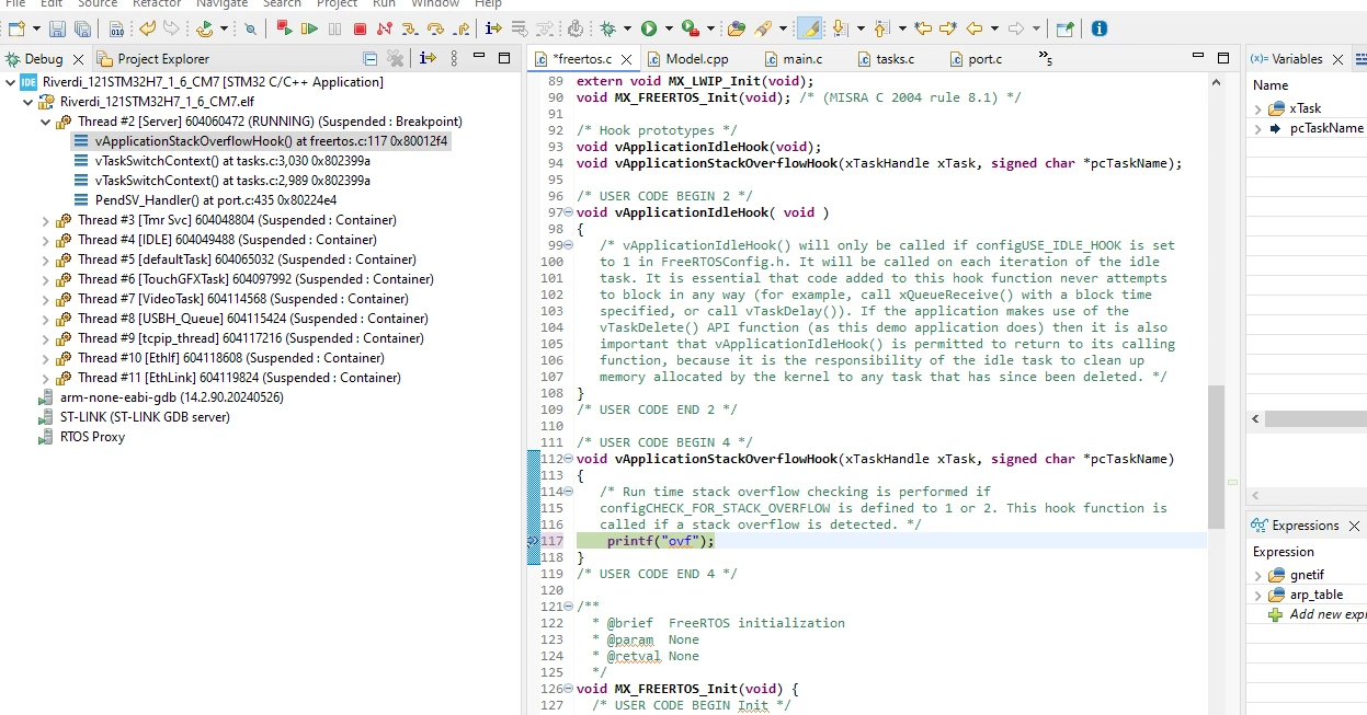

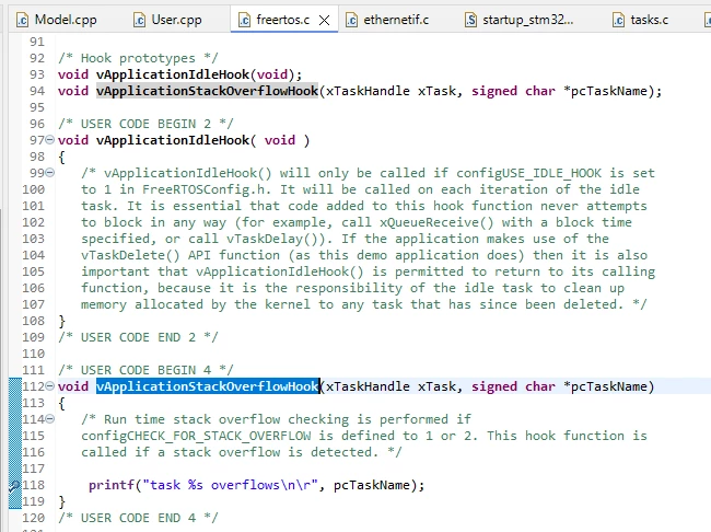

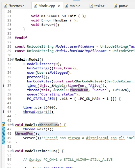

So I set CHECK_FOR_STACK_OVERFLOW = 1, trigger a stack overflow by an infinite recursive and set a bkpoint in
But when I run the code I just reach HardFault_Handler
What am I wrong ?

Not in this case.
The check is done when tasks are switched which happens on the millisecond scale. If the overflow happens before then and a hard fault is produced, it will not be prevented. Calling a function recursively will overflow the stack very fast. It is not a magic solution that works all the time without limitation.

Ok, but I expect that if I call recursively a function without any limit as soon as far that stack will going to saturation and I expect that the FreeRTOS signal me that condition if I select one of the option available.
I am right ?
TDKBest answer
May 13, 2025 1:56 PM UTC
Not in this case.
