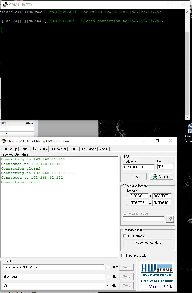

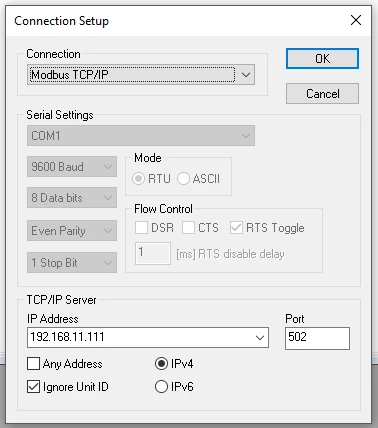

I modificated my task function:
void ModbusTask(void *pvParameters)
	if (eMBTCPInit( MB_TCP_PORT_USE_DEFAULT) != MB_ENOERR)
		InfoPrint("FreeMODBUS: fail init");
	if (eMBEnable() != MB_ENOERR)
		InfoPrint("FreeMODBUS: fail enable");
	InfoPrint("FINISH INIT modbus");
	while (1)
		eMBPoll();
and enable debug output. So I use to connect Hercules SETUP utility by HW-group.com. I set IP address: 192.168.11.111 port: 502 in client mode. And I know, connection is good.
But how to connect client with modbus I don't know....
