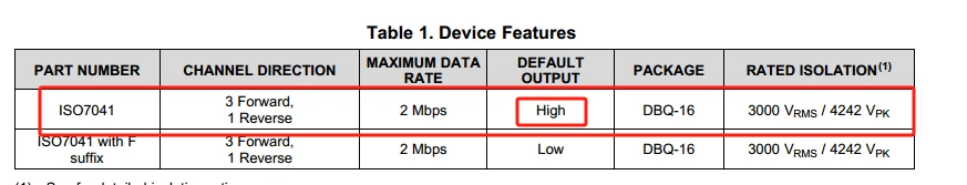

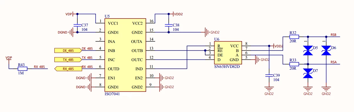

Hello everyone, I encountered a problem while using STM32L431 for RS485 development. I used the ISO7041 isolation chip, and in the initial state, the DE pin is low, while both TX and RX are high. The current issue is that when I turn on the power, reset, and plug in 485, both the transmission and reception of 485 are normal. However, when I unplugged and inserted 485 again, an FE error occurred. Why is this? Is it because the voltage level does not match after inserting 485?
Debugging found errorsflags=2, which should be FE errors。

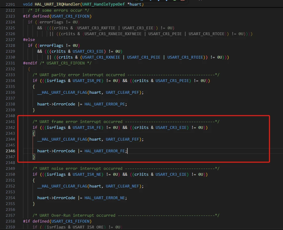

My current solution is to modify the HAL library generated by CUBEMX, directly delete the judgment of CR3 EIE value and clear the flag bit. Is this correct? Will it affect the transmission and reception of other serial ports, or can this flag be detected elsewhere and cleared elsewhere.
 // if (((isrflags & USART_ISR_FE) != 0U) && ((cr3its & USART_CR3_EIE) != 0U))
 if (((isrflags & USART_ISR_FE) != 0U) )
 __HAL_UART_CLEAR_FLAG(huart, UART_CLEAR_FEF);
 huart->ErrorCode |= HAL_UART_ERROR_FE;

jiangfan
Dec 5, 2024 3:20 AM UTC
After a brief look, I suppose you may do:
detect unplug of RS485, reset/re-init RS485 interface, then RS485 can work as if it is the same as power on of the board.

Andrew Neil
Dec 5, 2024 11:55 AM UTC
Because you get a glitch on the unplugging and/or re-plugging.
This is perfectly normal, and to be expected.
PS:
or the unplugging and/or re-plugging occurs during a frame
Senior III
Dec 5, 2024 2:25 PM UTC
if you get frame error, reset the uart errors and start afresh, it should be ok. RS485 is not auto recovery , you have to have routines to detect errors and take action.
