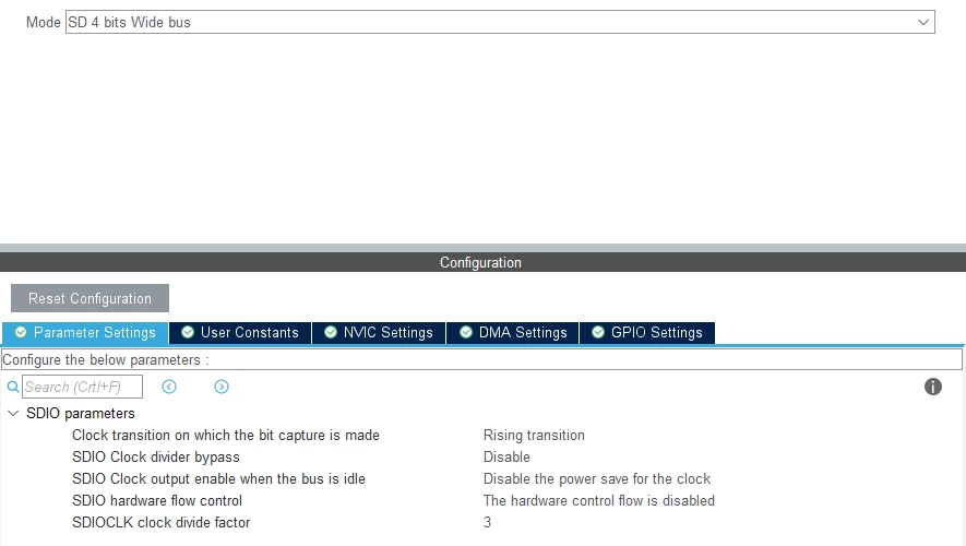

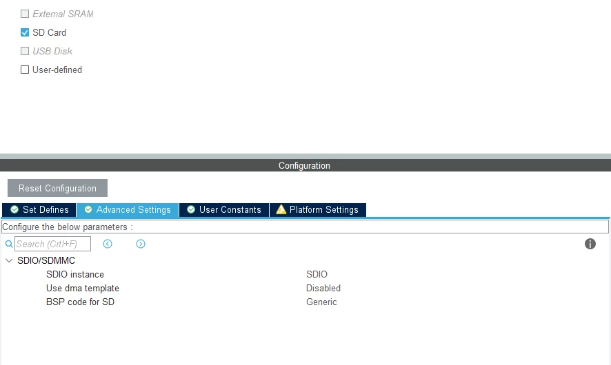

OK, with your encouragement I did dig deeper. I set the break point in "bsp_driver_sd.c" where it returns "hsd->ErrorCode" from "HAL_SD_ReadBlocks":
__weak uint8_t BSP_SD_ReadBlocks(uint32_t *pData, uint32_t ReadAddr, uint32_t NumOfBlocks, uint32_t Timeout)
 uint8_t sd_state = MSD_OK;
 if (HAL_SD_ReadBlocks(&hsd, (uint8_t *)pData, ReadAddr, NumOfBlocks, Timeout) != HAL_OK)
 sd_state = MSD_ERROR; // break point, check hsd->ErrorCode
 return sd_state;
Writing to file sometimes works, but eventually it returns "hsd->ErrorCode = 0x20" which means HAL_SD_ERROR_RX_OVERRUN:
#define HAL_SD_ERROR_RX_OVERRUN SDMMC_ERROR_RX_OVERRUN //!< Receive FIFO overrun
#define SDMMC_ERROR_RX_OVERRUN 0x00000020U //!< Receive FIFO overrun
How do I fix HAL_SD_ERROR_RX_OVERRUN?
I dont use DMA, my settings
